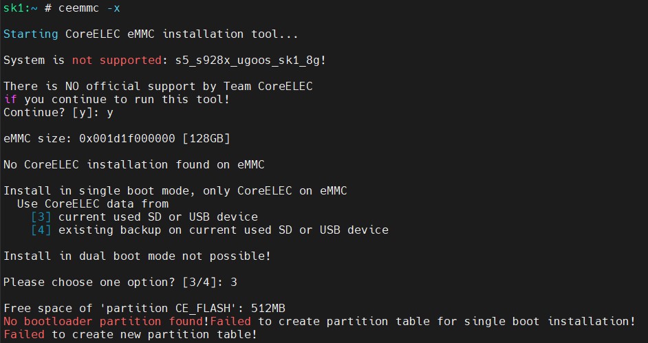

hello, i’m getting this error when i try single to set up single boot mode with ugoos sk1 on CE-NO (latest)
the latest android 14 v2.0.4 was installed before with burning tool.
maybe this brought up the error?
should i flash back to android 11 before trying a single boot emmc installation?
thx in advance
wiki not updated for CE-NO?
Did you really read the link?
