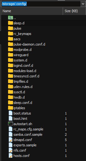

i’m using an autostart.sh script for disabling the player leds - this works if i shutdown the device, but not when i’m coming back from hibernate. maybe one of you guys has a solution for that?
thanks in advance
autostart.sh (140 Bytes)
Create file /storage/.config/sleep.d/50-custom.power

thank you @vpeter i will give it a shot :folded_hands:

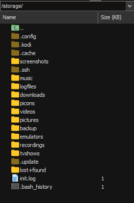

there is no sleep.log file after reboot/shutdown in this folder
maybe this folder is to mention?
interesting behaviour - if i restart via ssh (reboot now) - the script autostart.sh works, but restart from the gui doesnt work…
where can i find the logs for WoL?
Must be /storage/.config/sleep.d/50-custom.power.

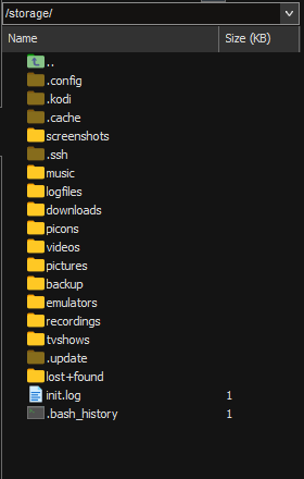

your script:
output (after reboot and hibernate triggerd):
I don’t know what is wrong. It should work I think.

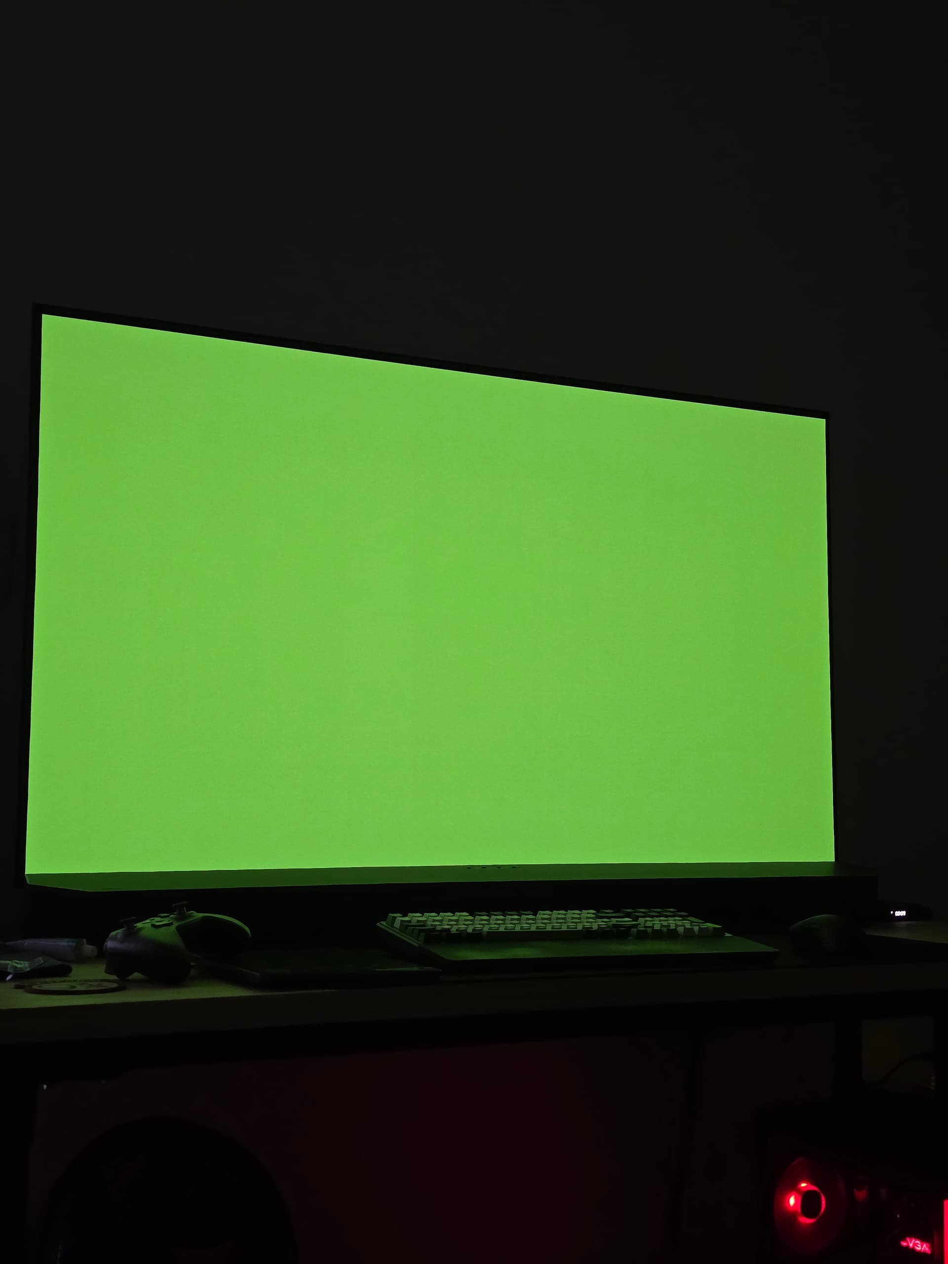

Does anyone else with a TOX3 s905x4 get a green screen after restarting the device? This forces you to unplug and plug the power cable back in to fix it? This didn’t happen with the old CE21 kernel. The device is connected to a Samsung Q990C Soundbar; I don’t know if that’s related.
No problems on my 2 Tox3 atm.
What version and date are you running?
I’m using 20251205 and 20251207. CE NO Nighties. Both do not exhibit that.
Both are connected thru hdmi to AVR’s (Yamaha and Pioneer,) and then to TV’s (Samsung’s). No CEC.
Baz
I’ve been having this problem for months; it used to happen when I switched HDMI ports on the TV, or when it resumed from sleep mode. Nowadays, it only happens when I restart Tox3. I’m using version 20251205.
