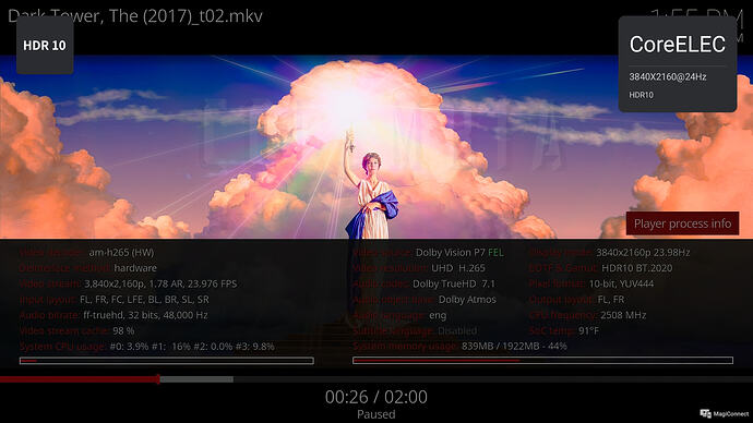

Thanks Team CoreELEC and @ frodo19, update to ppi and shortcut icon when pause playback!!!
Most Excellent !!!z
where i Find the Frodo update to ppi? Thanks
It’s builded in the CE NO estuary.
.. its just small correction :slightly_smiling_face:
I tried it. Thank you. However with Display-led, Video Source shows ā€œSDRā€. Instead of FEL etc.
Thanks @frodo19. The indication of Dolby Vision profile only appears on some movies and in many it’s just Dolby Vision.
No, it’s OK for all types of dv.
Just need the update the kodi database.
Click on the movie , then rescan, scan from the live sources (internet), choose your scrapper and update.
After that, will show all the profile information.
Yes it works thank you.
I use the Jellycon client which does not interact with or populate kodi’s libraries.
I also use the jellycon client and player led DV mode. I also note that the PPI always says SDR as well. Just like en6ads has found.
@en6ads @danceden99-ops
it seems pretty obvious from the last response that the HDR information is being read from the database not the playing file
if you are not using the database then you’re not going to get information
even using jellyfin to sync it’s unlikely jellyfin will even put the info into the database
if it’s not working ā€œwith jellyfinā€ then use it normal, if it then works without jellyfin complain to jellyfin
Yes it appears so. I’m used to using another build on my AM6 that populates ppi from the playing file, not from db. I believe there is a kodi pull request that has yet to be committed that does this. If that gets merged in Kodi then hopefully we’ll have a solution.
Edit: it was this PR, committed yesterday: [GUI] Expose live A/V bitrate, queue level and extended audio/subtitle labels by CE-Repo Ā· Pull Request #28355 Ā· xbmc/xbmc Ā· GitHub
But it’s just to add live audio and video bitrates from the playing file, not other metadata from the RPU such as levels info. Maybe another request to also add these is needed.
Now ,with Kodi Keymap addon,you can have Jamal tiny ppi addon mapped.
And CoreELEC/Frodo19 ppi mapped to a different key
And compare!!
Both are accurate
