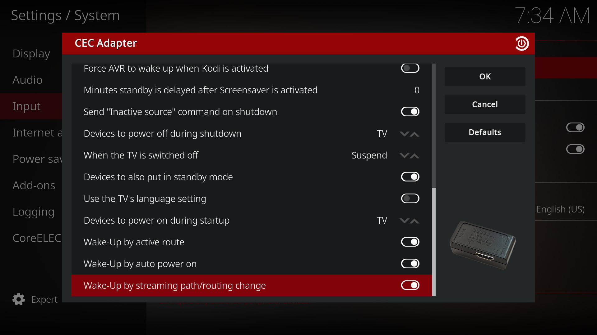

Nobody have the idea to check CEC settings?
Maybe it helps?
