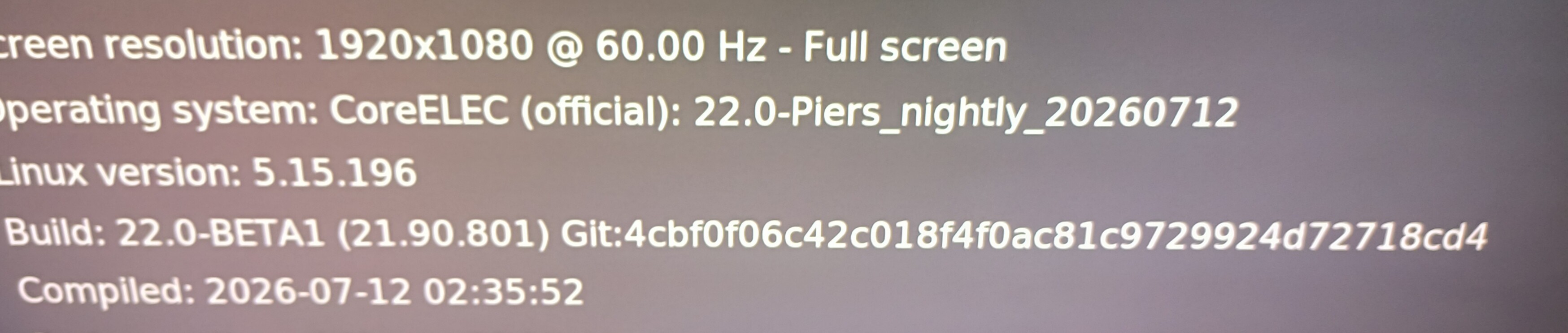

Crunt
12 July 2026 11:00
3918
Yay! it works with this build, thank you
Then I know where to look at and will try to get it fixed next week.
