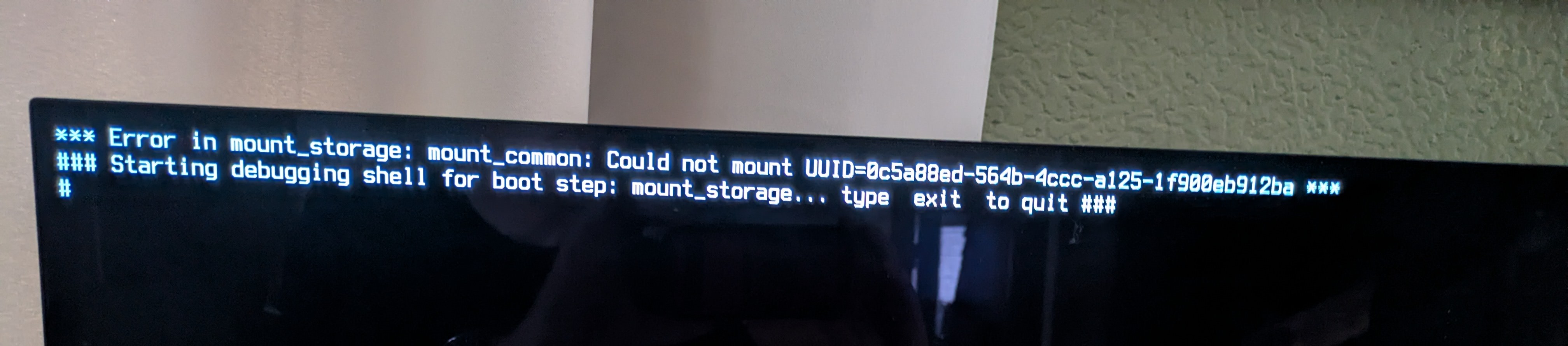

It looks like there is a issue with USB drivers and this will cause a boot loop. Will take some time until we fully fixed everything for any hardware configuration.
since the version 20241222 and after that I have the problem my OdroidN2+ does not start anymore, see screenshot. what can I do? Versions before 221224 work.Even if I install the latest version from 25.12.24 on the MMC, I get the same error message, but if I install the version from 06.12.24, everything is fine.
