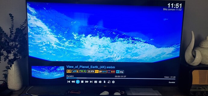

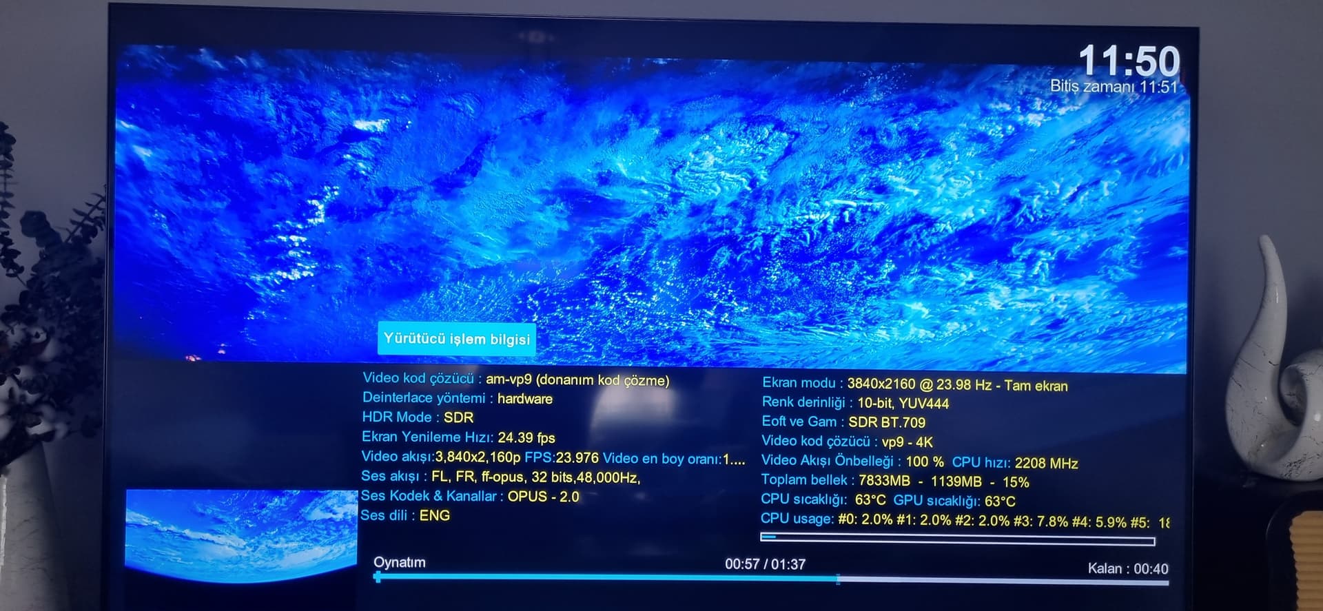

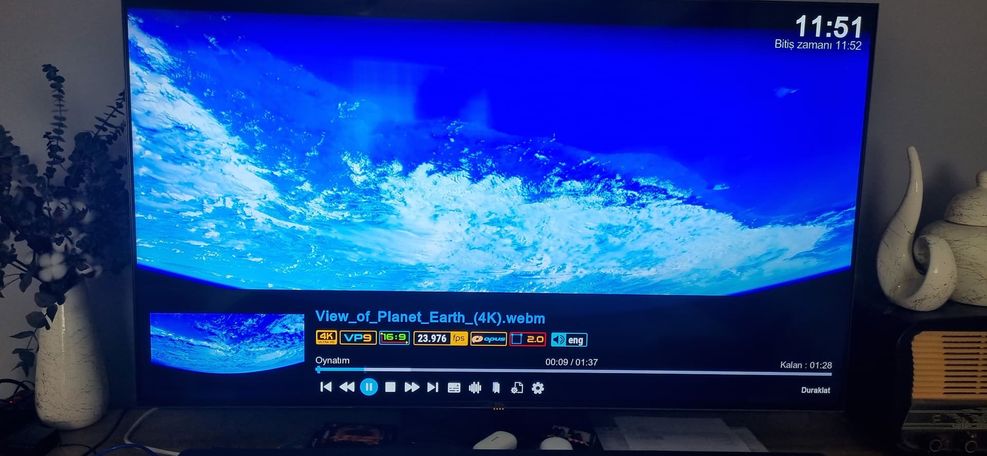

View_of_Planet_Earth_(4K).webm yes, plays

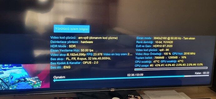

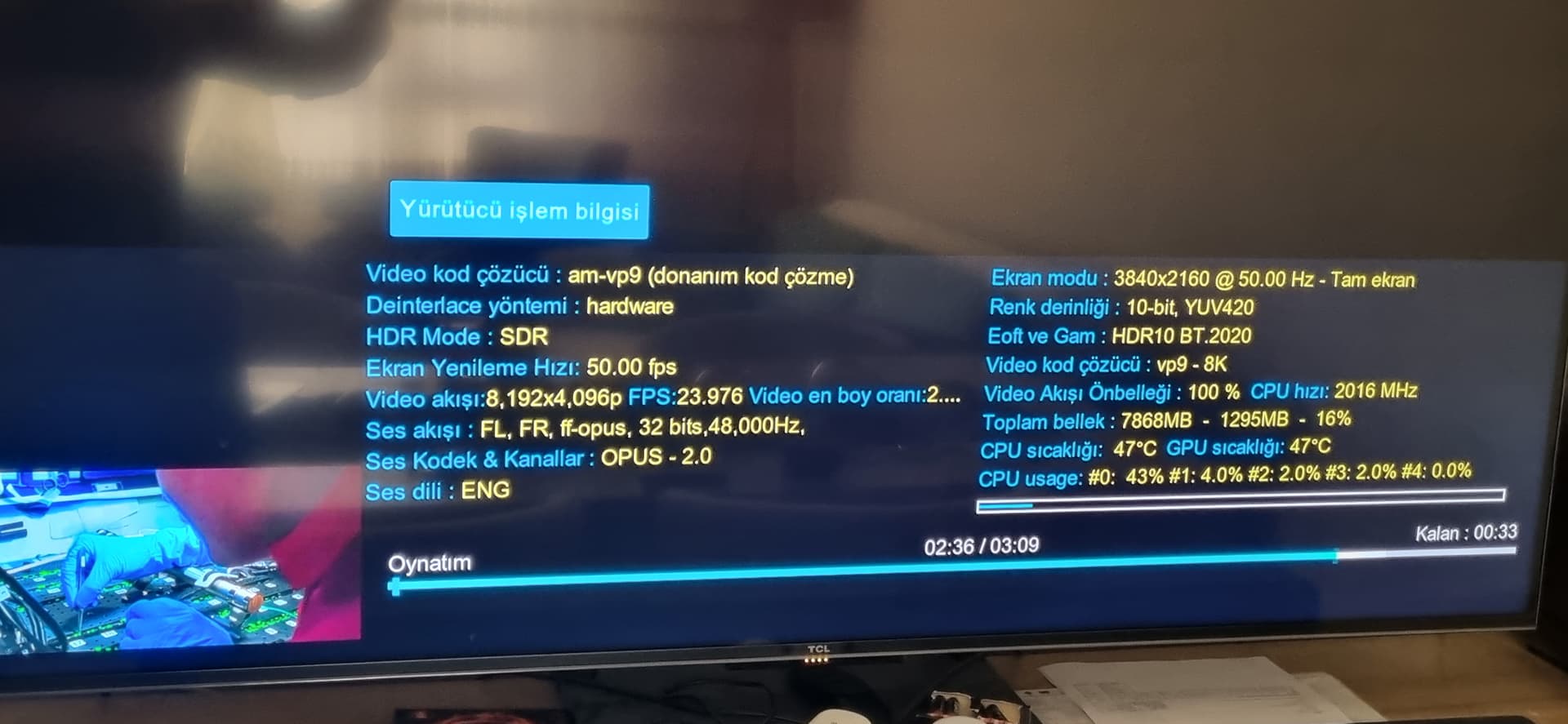

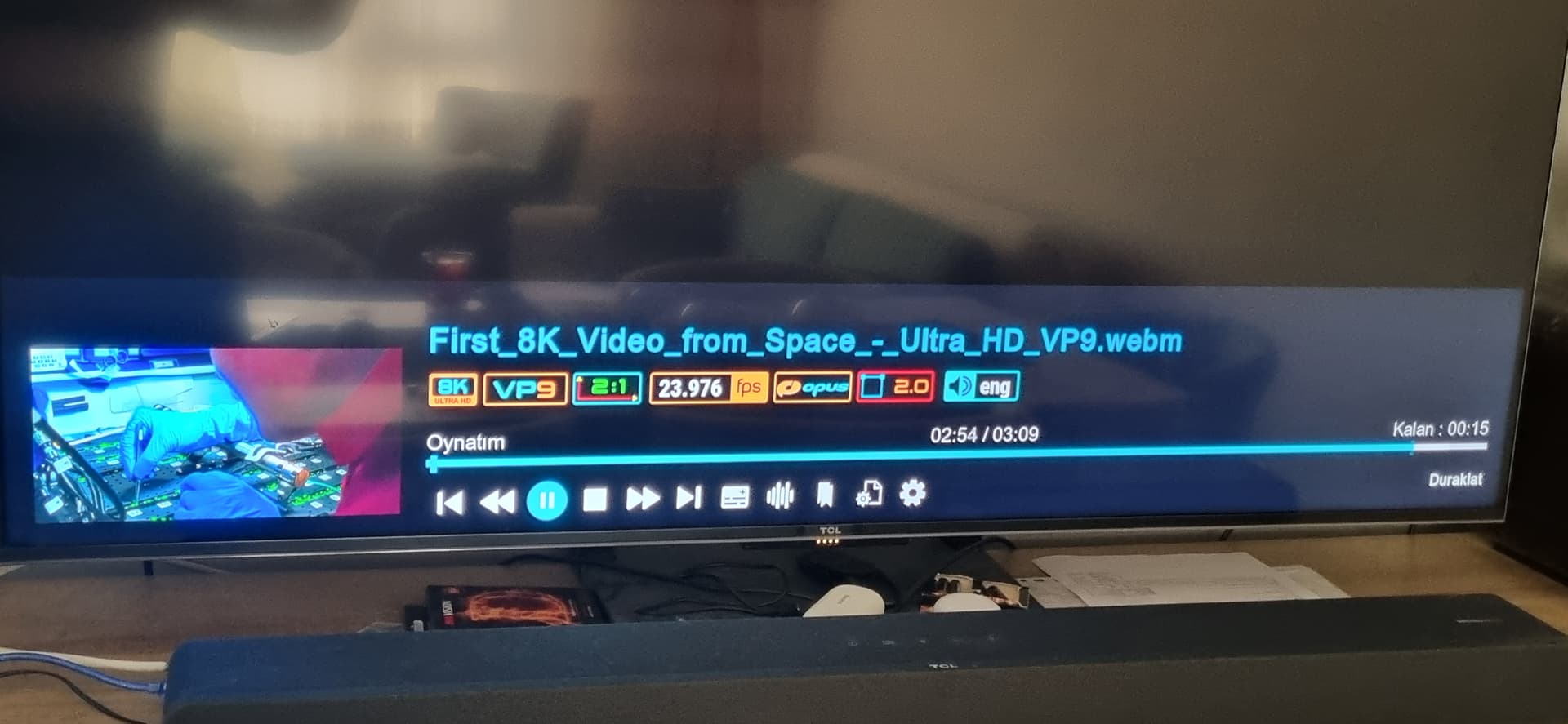

First_8K_Video_from_Space_-_Ultra_HD_VP9.webm this video will not play. stuttering during playback.
Thanks for confirming, will need to look further whether anything can be done about this.
First_8K_Video_from_Space_-_Ultra_HD_VP9 this video is also problematic with SK1

The sample First_8K_Video_from_Space_-_Ultra_HD_VP9.webm have a very high bit rate and big frame packages.
The decoder buffer will be adjusted with next nightly build.
