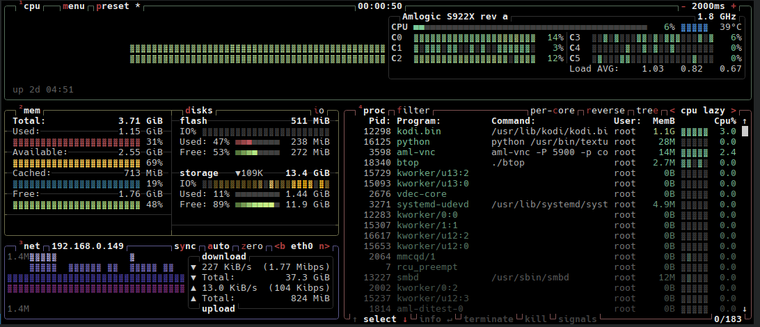

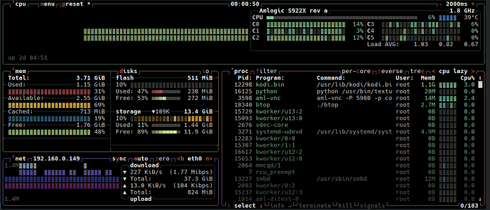

On am6plus is working play video after wakeup from suspend. Only i saw stuttering due to 100% working of cpu. This stuttering/100% using of cpu is out after cca 2 minutes of playing video after wakeup from suspend. I have also a issue of not working of my cec tv remote on CE22NO.
https://paste.coreelec.org/RefuelSettled
In comparing of logs i identified only changing of order of lines in dmesg and changing of number behind of stream input: from 13 to 11 (self repairing of counting in system during many testing ?). But maybe it means nothing (decoders of stream input are only 11 also in case of number 13).
After many my testing now know, that issue of not working of my cec tv remote is after changing of source from kodi to tv and back to kodi. So is not depend on suspending/wakeup = 2 different problem: of cec and of stuttering after wakeup for 100% using of cpu (on CE21NG is not this issue on same device).

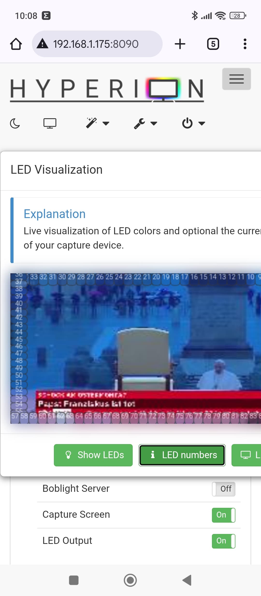

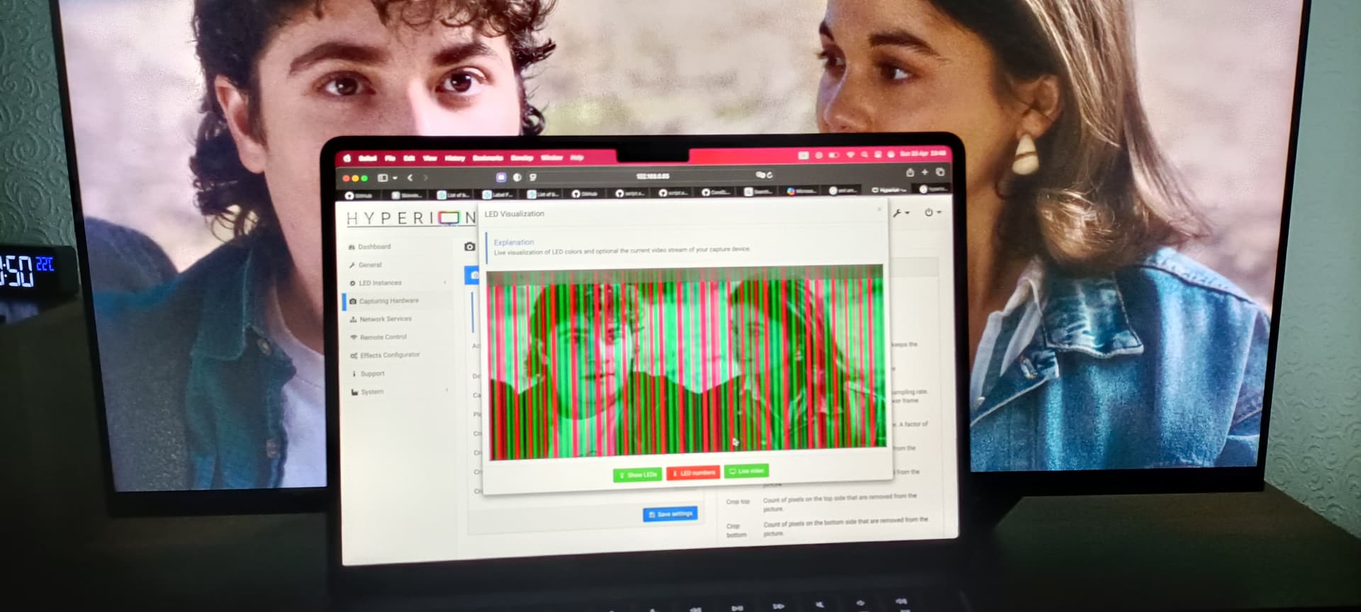

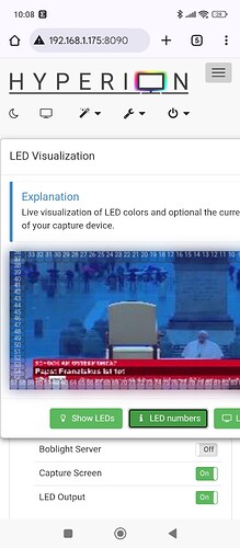

/dev/amvideocap0 is broken for h264 video in CoreELEC-no, which mean Hyperion-ng no longer works.
Any chance of looking into it please.
Just switched off using h264, did not spot any issues.
Is it only the live preview or the LEDs to?
Not sure what you mean by switched of using h264?
Both, the issue is also present when taking a screenshot in Kodi with a h264 video playing.

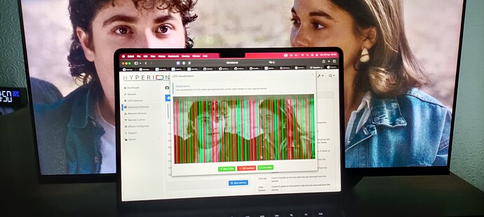

The issue happens on my Dune/Homatics Box R 4K Plus S905X4 box. H264 gives a corrupt screen grab but H265 works fine.

Just tested on my X96 X10 S928X and both h264 and h265 capture ok
So capture wise:-
S905X4 - H264 = corrupt, H265 = ok
S928X - H264 = ok, H265 = ok
Would it be possible to get H264 to capture correctly on the S905X4 box.

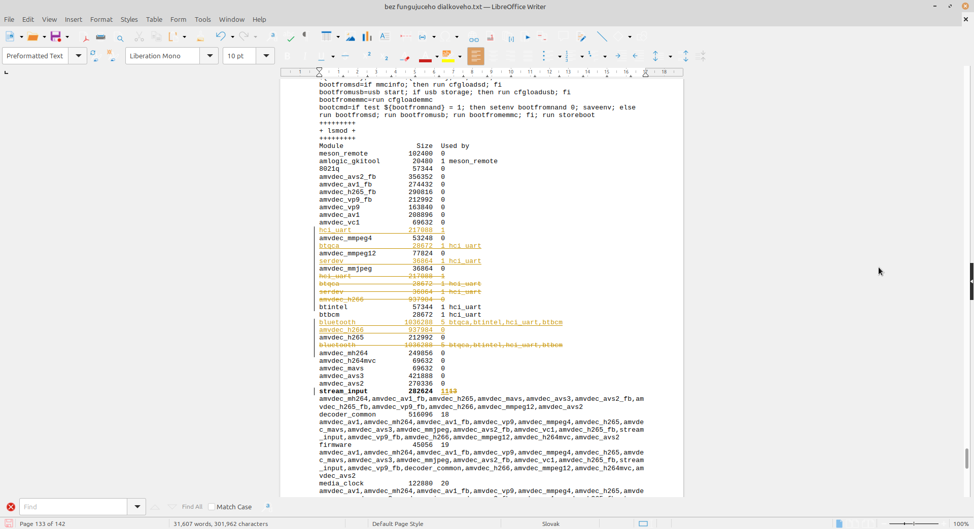

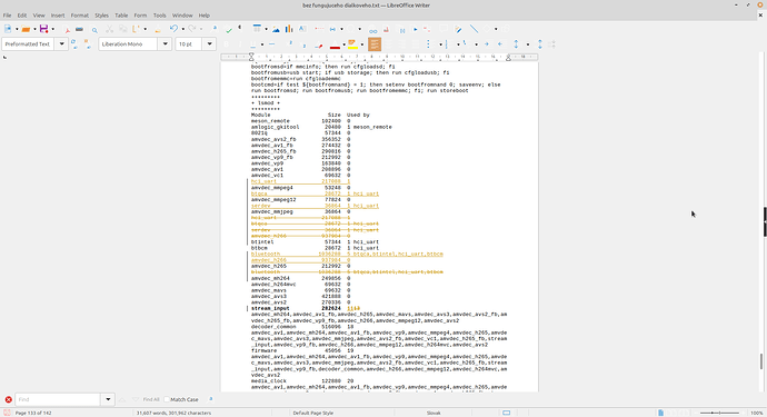

In comparing CE22NO to CE21NG on device Ugoos am6plus, in input stream of CE22NO is missing: amvdec_h264mvc, amvdec_ports and amvdec_real. As extra was added to CE22NO: amvdec_h266 which maybe really NOT support for s922xj.
Output from CE22NO: https://paste.coreelec.org/RefuelSettled
Output from CE21NG:

According to datasheet of S922x:
Amlogic Video Engine (AVE-10) offloads the Cortex-A53 CPUs from all video CODEC processing. It includes dedicated hardware video decoder and encoder. AVE-10 is capable of decoding 4Kx2K resolution video at 75fps with complete Trusted Video Path (TVP) for secure applications and supports full formats including MVC, MPEG-1/2/4, VC-1/WMV, AVS, AVS+, AVS2 RealVideo, MJPEG streams, H.264, H265- 10, VP9 and also JPEG pictures with no size limitation. The independent encoder is able to encode in JPEG or H.265/H.264 up to 1080p at 60fps.
No maybe really not…
No idea what you want to!?
The decoder driver loads but it will not work when hardware do not support it.
What is the problem?
No problem, i tried found reason that why is stuttering after wakeup from suspending of device at CE22no. At ce21ng is not stuttering after wakeup.
