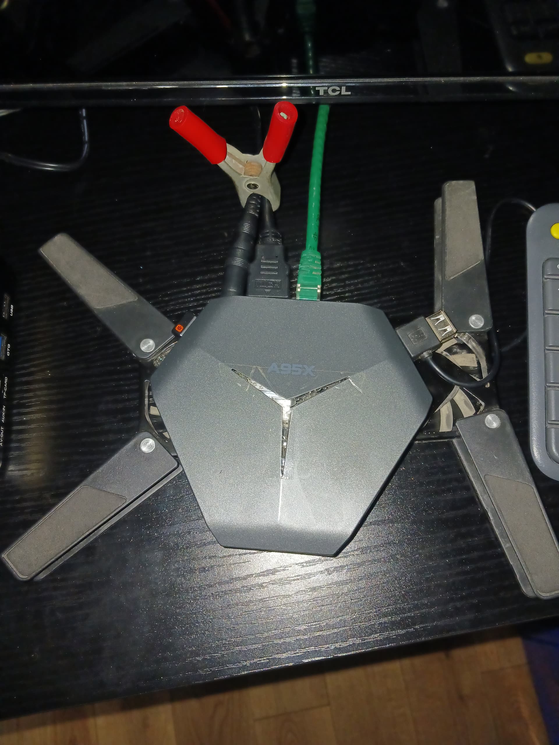

My Brother inlaw was using this Box,his kids dropped it, stepped on,kicked across room,spilled any number of juice,milk,etc,the 5 volt dc in jack solder us loose,so have alligator clip to keep side pressure on.
If you want to abandon ship ,let me know??
