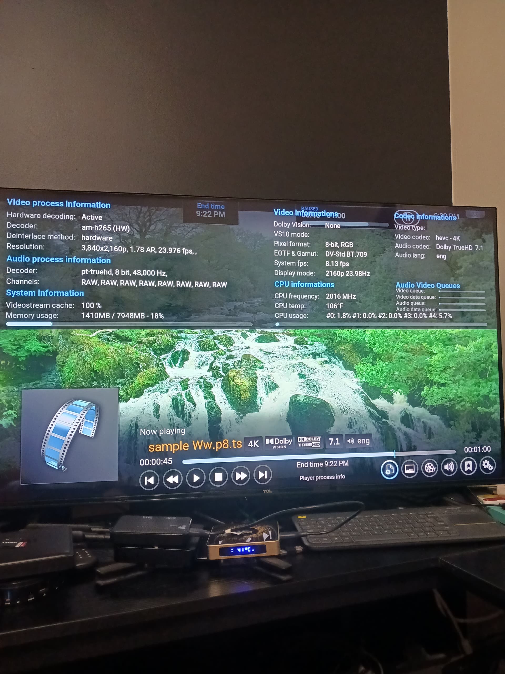

I also think it’s not wrong. Please will make a Android log to show what audio format is used. Your CE log shows it used TrueHD passthrough.
But as other users said you need a AVR for passthrough. So I am sure Android uses LPCM, not passthrough. But only a Android dmesg log (bug report) will show the truth.

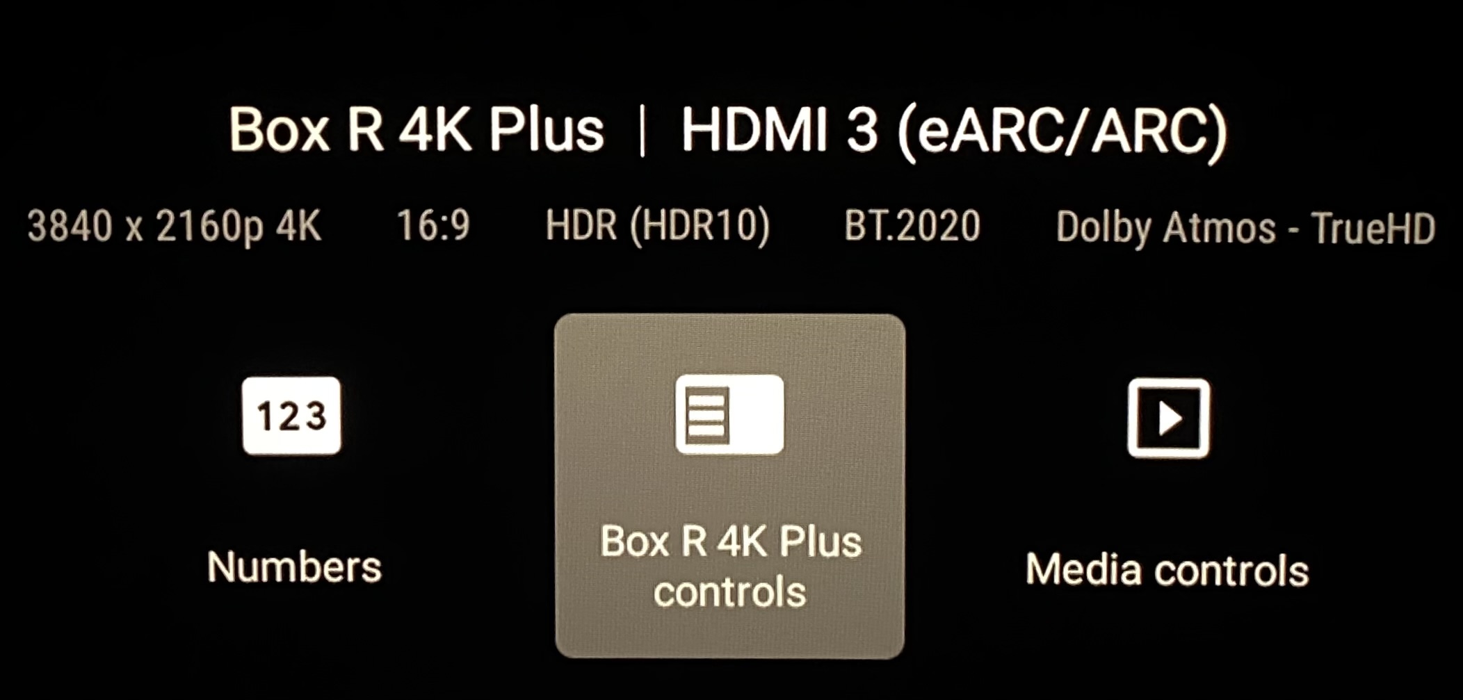

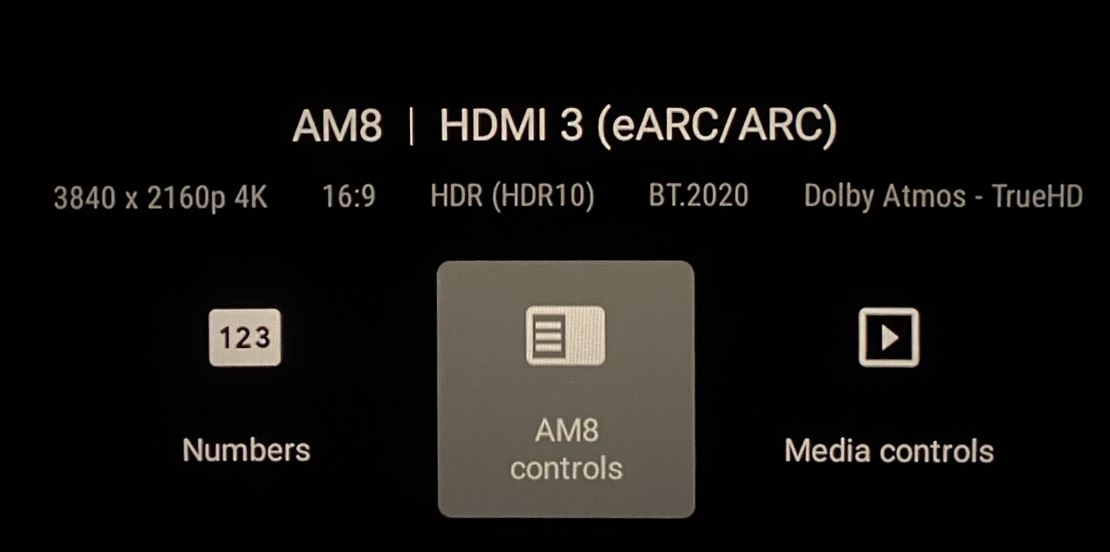

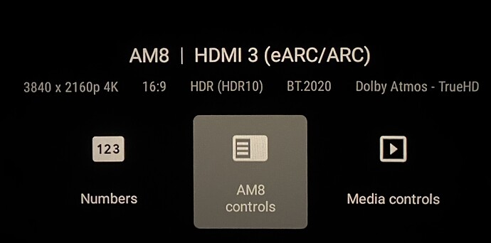

On CE trueHD there is no sound but on Android there is sound and the TV info window confirms this, I took pictures of both devices on Android

I got no idea why your TV shows True HD in info screen.
If you got sound despite truehd send from android it probably transcoding it itself.

When use homatics trueHD work
When use am8 trueHD no sound
