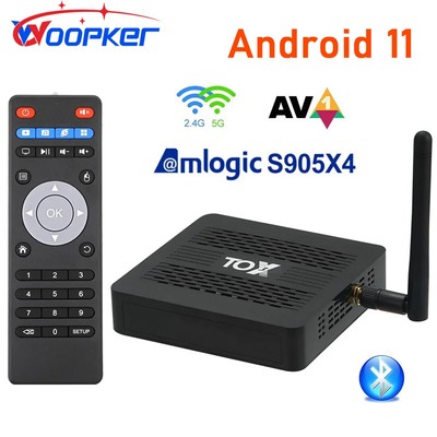

So my question is, what would be a good device for playing those files, for a decent price ?
I found an odroid-N2 (with emmc and psu) for 80€, seems reasonable to me. Wondering if this is fine, or maybe this board is lacking some features ?
TOX3 (not tox4)
example only.
Edited, found one cheaper.

I ordered the cheap TOX3 from Aliexpress and got it in 3 weeks (to South Africa). I replaced the firmware with Slimbox 34 ATV to prevent the ‘Missing partition super on eMMC!’ error and then was able to load CE from SD card.
If you don’t have a DV capable display, then I can easily recommend this box for CE use.
I was about to ask what a recommended box was if DV wasn’t required. Sounds like TOX3 meets that requirement.
