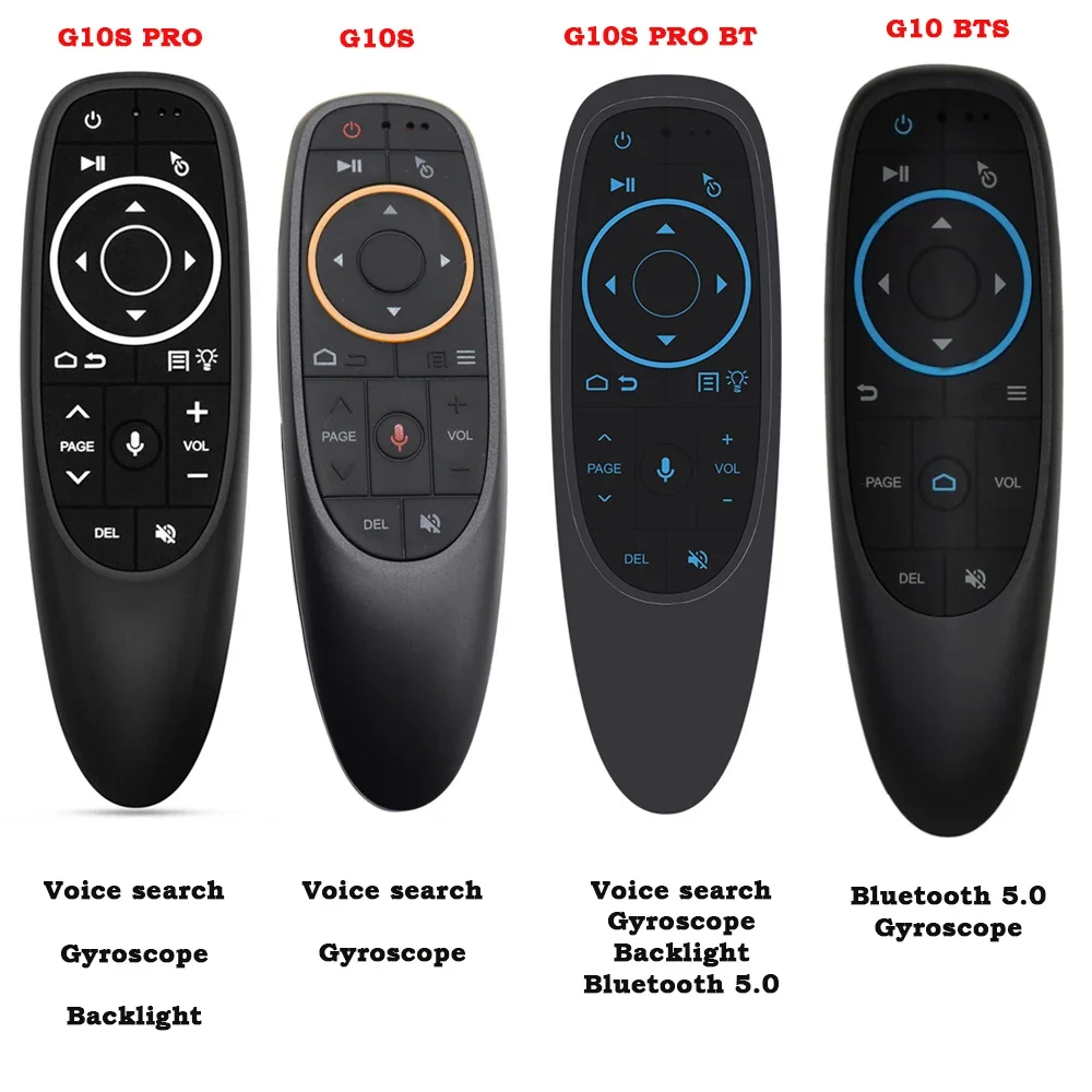

I use G10S Pro remote on my Homatics box, works great using the included usb adapter, or BT, why is IR necessary?
It is not necessary, I usually us the G20 or a USB-HID remote since I like number keys but the IR is useful when you have a CE device that support bl301 injection wakeup (none on this list AFAIK). Some people do use automation like Control4 and Harmony remotes an hubs.
If you’re planning on using both CE and Android, it’s useful to have a remote that does both IR & BT. It’s not possible to have a BT remote paired to both CE & Android, so you use the IR function to navigate in CE and BT for Android.
Or you can also use just one remote for both by sticking to CEC control, using only IR, or a remote with its own wireless USB dongle.
But if you’re primarily using CE, BT is more responsive than CEC or IR, and it’s not directional.
I use USB-HID RF since it also works on both Android and CoreELEC and gives more keys than CEC and is not line of sight. My remote has programmable IR codes too so I could even use it with bl301 injection. With the newer devices, I end booting from EMMC then shutdown then power up long press restart to go to CE.
