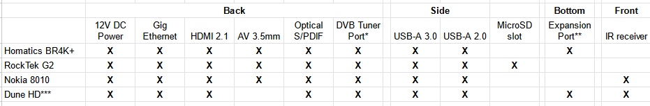

Full passthrough (TrueHD/DTS-HD) is a standard CE feature on just about every CE supported device.
Homatics Box R Plus / Dune HD R Plus / Rocktek G2 / Nokia 8010 (s905x4-k)
Kinhank G1 (s905x4-j)
Amazon FireTV Cube 2nd gen (s922z)
All these devices have DRM support for the Android/FireOS side.
The R Plus from Dune & Homatics, Rockteck G2, Nokia 8010 are all clones, and using slight variations of the same AndroidTV firmware. The Dune HD has the benefit of including an IR receiver and SDcard slot. **The G2 includes IR receiver & sdcard slot. Not sure about Nokia, the Homatics R Plus has no IR or sdcard.
All of these boxes are from SEI, so the Homatics box has the best company support, because Homatics is SEI’s direct to consumer brand.
Rocktek G2 include IR receiver and sdcard slot.
Nokia and Dune/Homatics has no sd card slot.
Many thanks for the quick response YadaYada.
I will probably go for the Dune HD R Plus, for aesthetics (I rather prefer black finish over the white/coppery from Homatics) and also because I would say that Dune HD has a better support, or at least is more accesible, they publish update notes and so, of course I refer to the Android TV part.
But, can I do the dual boot with the USB 3.0 port?
But Rocktek G2 has no gigabit ethernet port, isn’t it?
