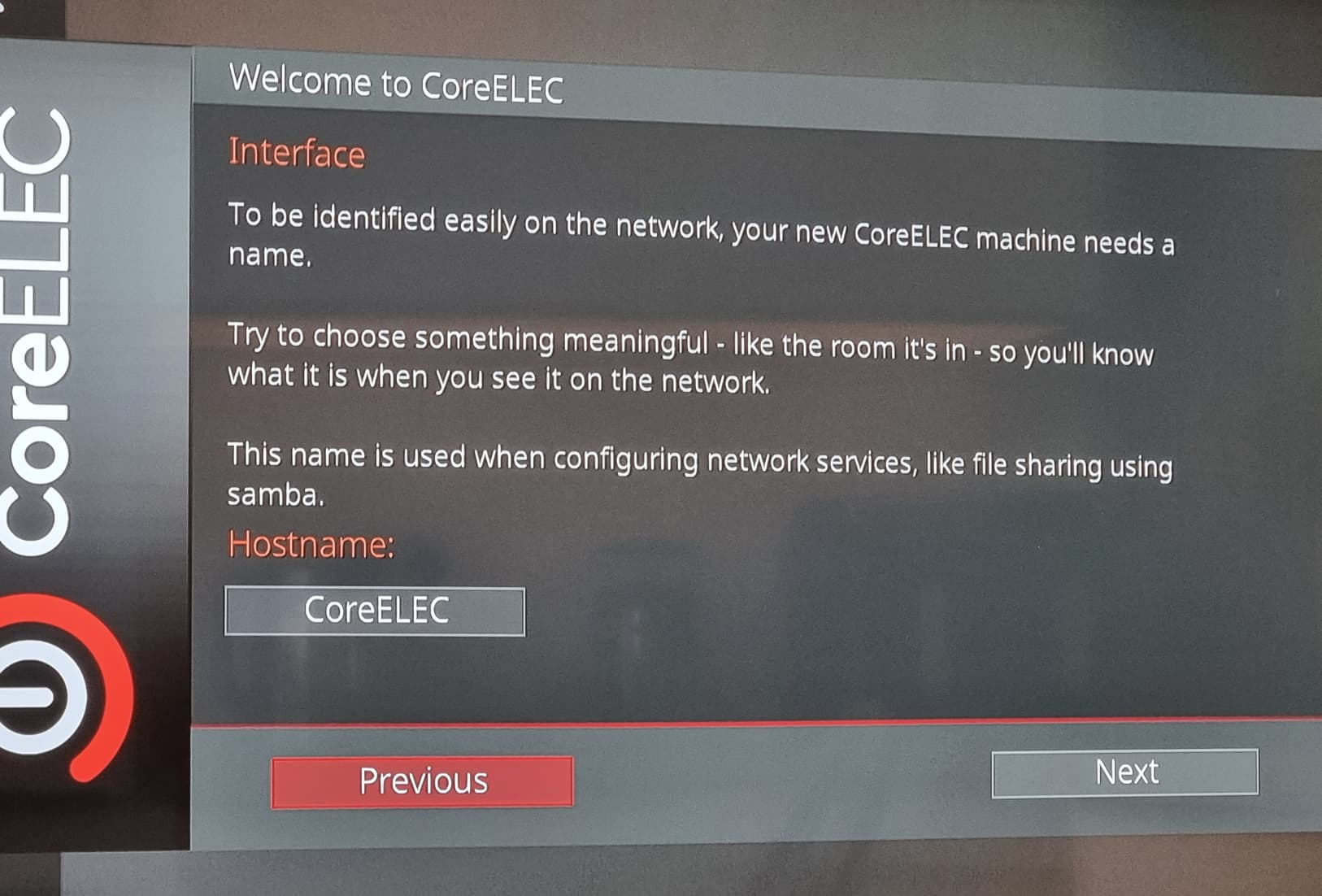

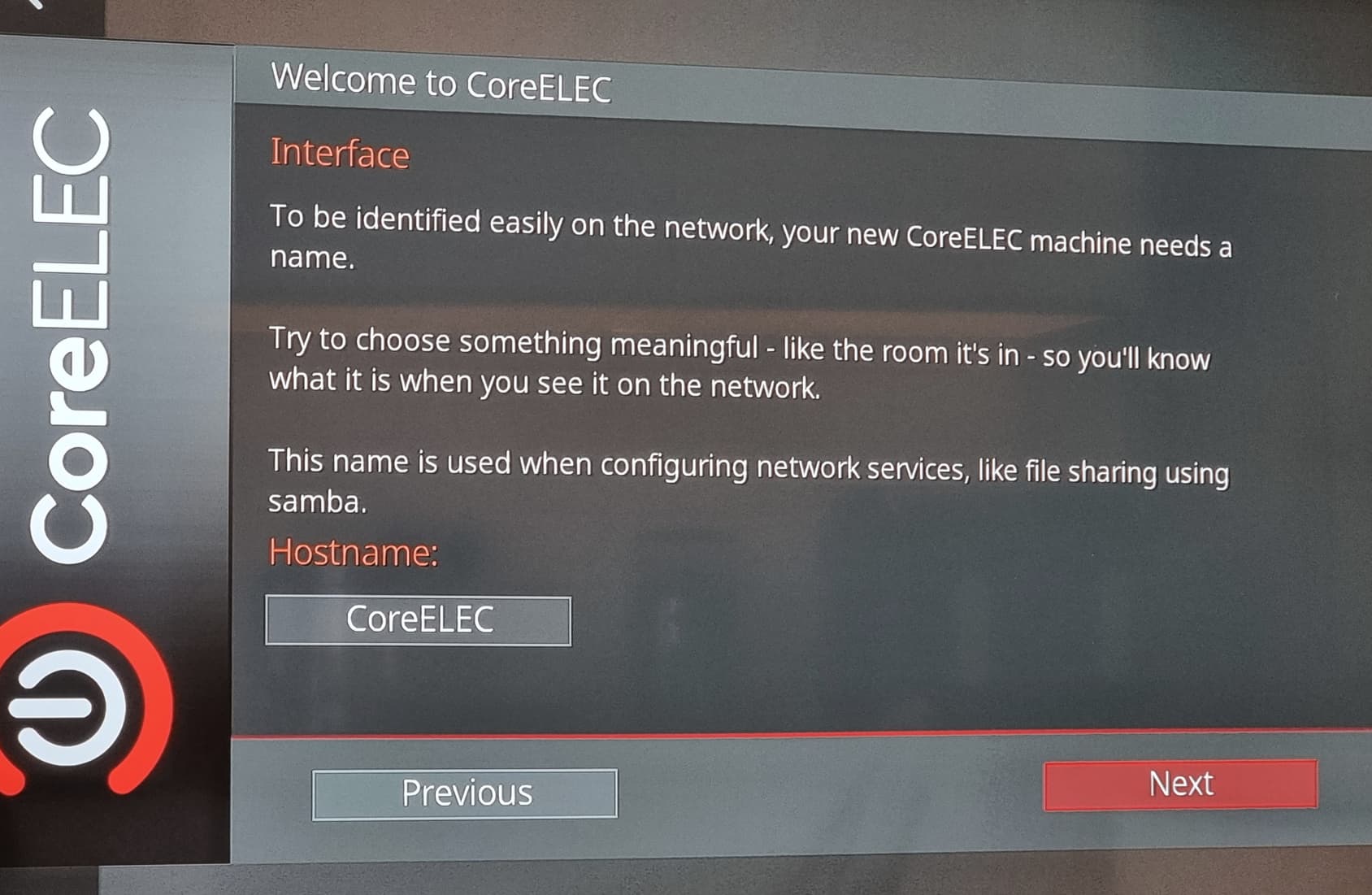

When setting up CE (NG), the Previous and Next buttons are indistinguishable for someone with red/green colour weak vision (up to 10% of the male population).
The Kodi button colours are fine and easily distinguished.

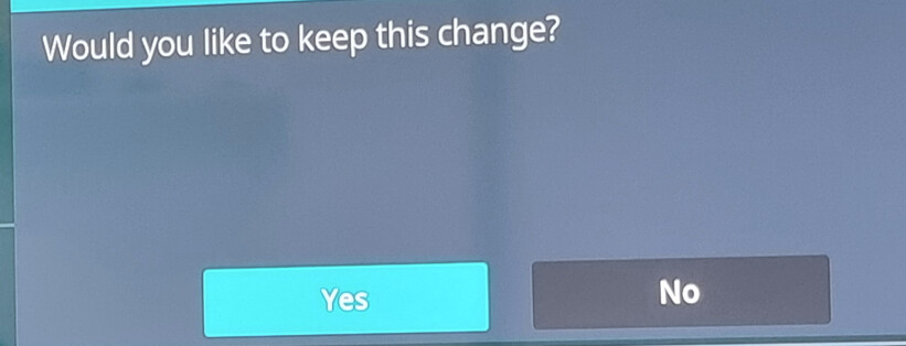

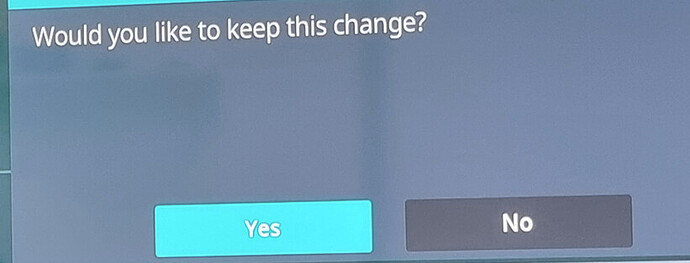

I’ll ignore the digs at my disability (I only came here for support after all), but are you saying that the “Welcome to CoreElec” hostname/wifi network etc. setup screens are under the control of the Kodi app?
As per the prev images, by contrast the Kodi buttons are very clear as to which button is selected.

@Vasco tx for the reply. The images I posted were the colours present with CoreELEC-Amlogic-ng.arm-21.2-Omega-Generic.img.gz. They do seem to change rather depending on which monitor is used, of course, but I am advised that ‘Previous’ is grey and ‘Next’ is blue. Which is odd since it’s red and/or green which causes me an issue. But using colours of similar intensity is not a good idea when highlighting an item.

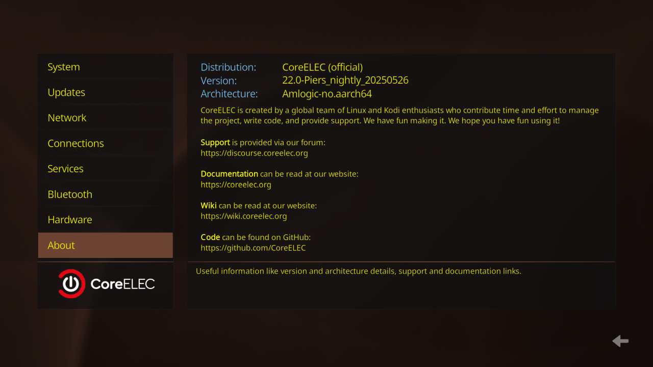

I confirmed after copying service.coreelec.settings to .kodi/addons I could modify the colours. This is
service-CoreELEC-Settings-mainWindow.xml with white to yellow and red to blue with a brown theme FWIW

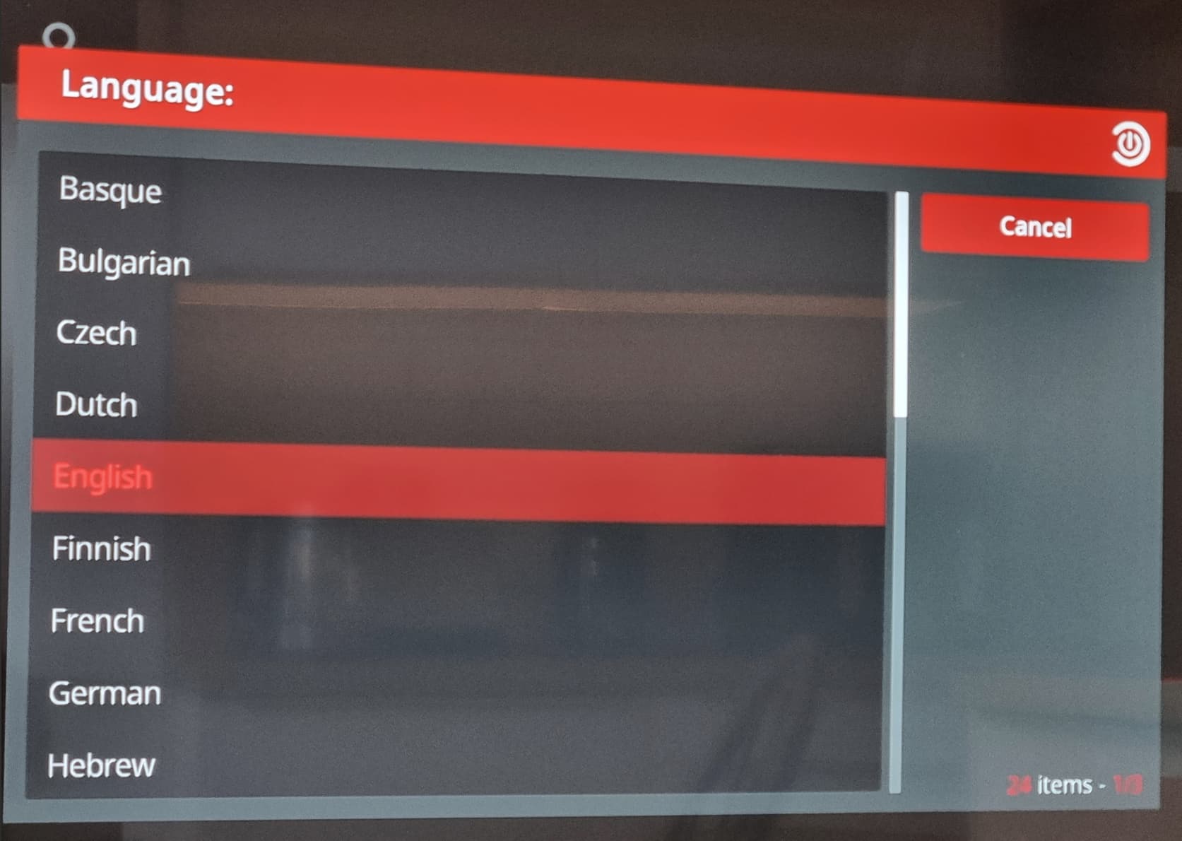

I managed to get a 2024 nightly of NO to boot (the current nightly won’t boot) and here are some example CE setup screens for comparison:
Even I can see that the ‘highlight’ colour is red when pasted here, although on the TV it is not very distinguisable at all. For some reason the mobile’s camera accentuates the solidity of the colour. (All TV & mobile images settings are at the defaults) It seems that the main issue is of the (lack of) brightness of the colour used for highlighting.
