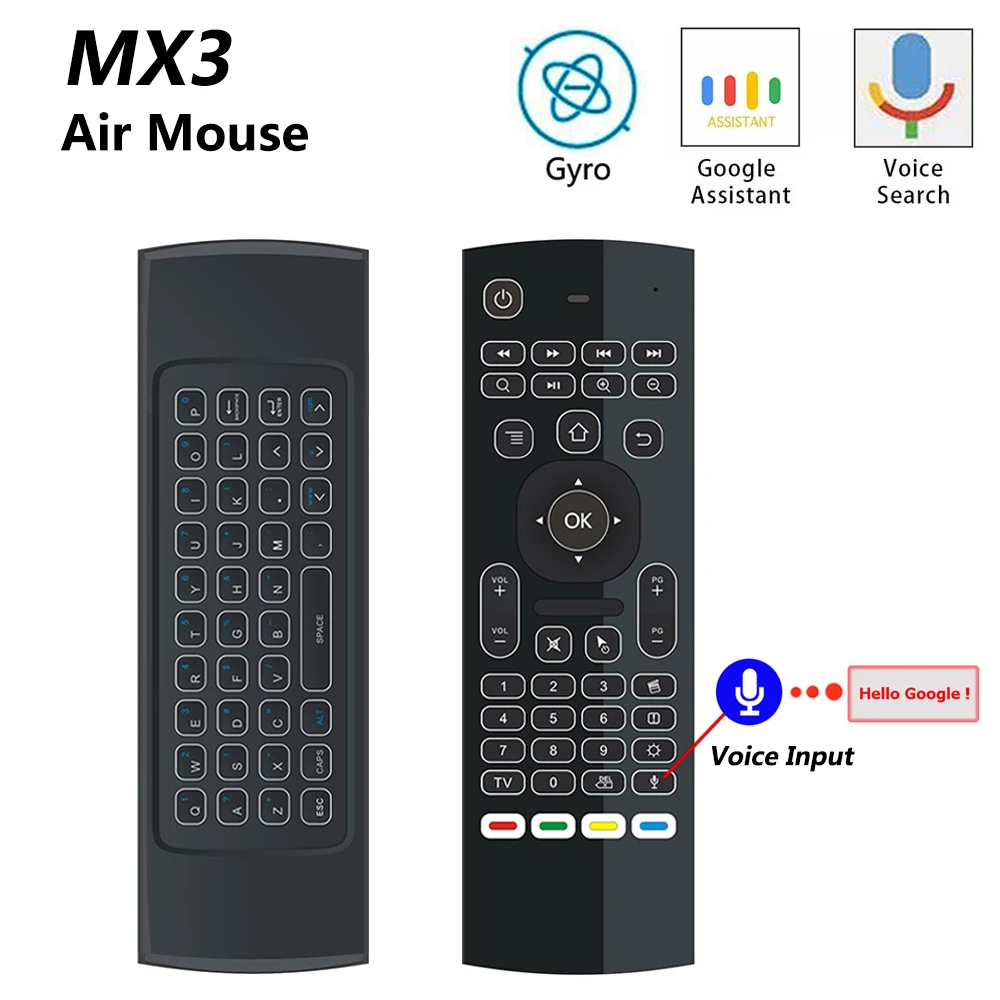

Original air mouse and other air mouse + keyboard control.Both give the same error.
The config file is the config file I use in kodi 18.
other remote G10 air mause
crazyturk, I setup original remote got with a device and it is working ok.
I used this to setup.
echo "meson-ir * beelink_bt_ir.toml" > /storage/.config/rc_maps.cfg
