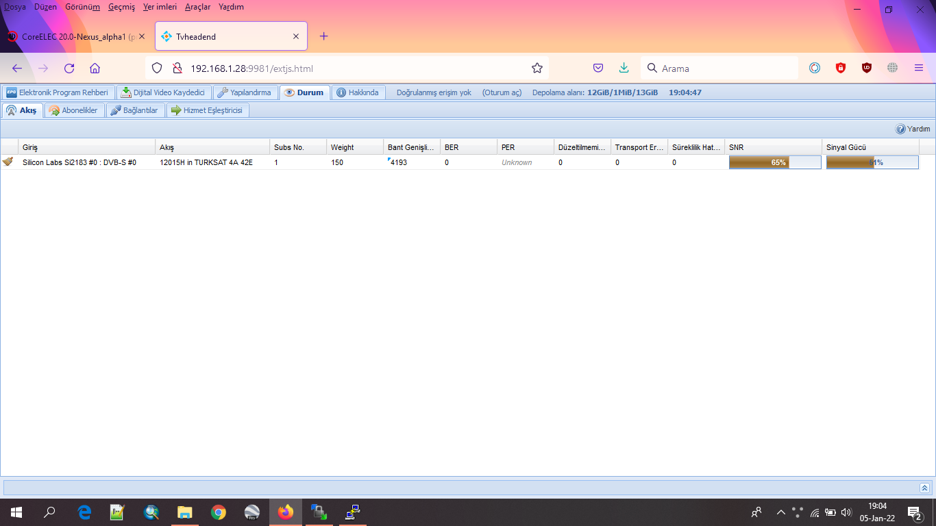

Hi, After nexus new update, CrazyCat knows USB tuner but does not show broadcast.

I think you use the DVB driver si2157?
It looks like a kernel oops so the chance to get it running again is almost 0%.
Switch to a SAT>IP system as nobody is able to handle DVB driver errors.

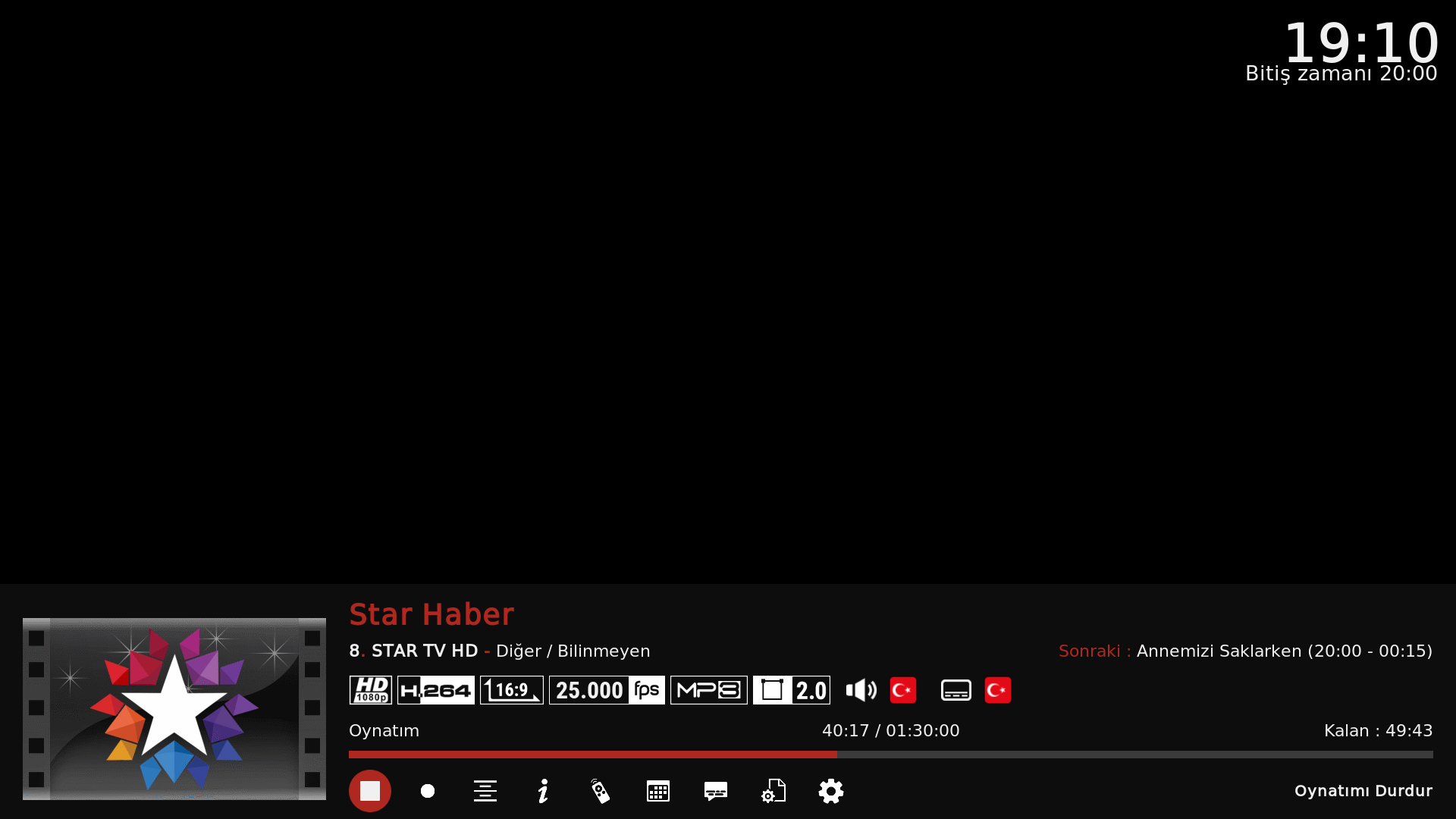

I have made a clean installation. Unable to watch videos including Live TV, Netflix, IPTV and YouTube.Black is the blank screen.
My device Beelink GT King Pro
Yes, remove your DVB hardware and the other stuff should work again, maybe

@Portisch Thank you for your help. I removed the DVB hardware But it didnât work
Everything works in the previous night.
@crazyturk I have currently no idea so I will need to do some test images to find the reason. But not before next weekâŠ
