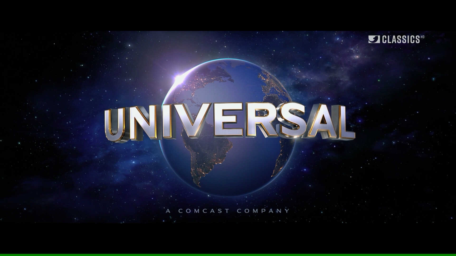

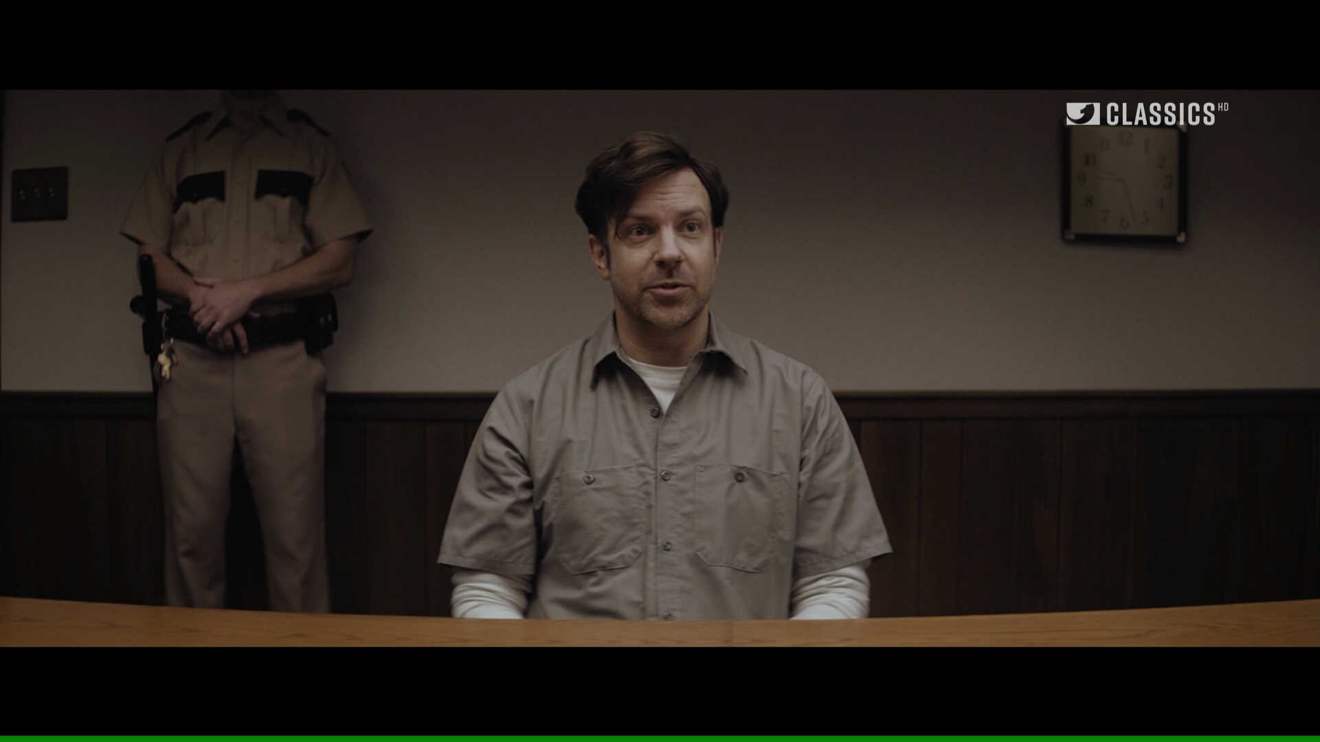

When playing back recordings from the AverMedia EZRecorder 130, a green bar is displayed at the bottom of the screen:
This only applies to CoreELEC. No green bar appears when using Kodi on Android on the same device. Not even with Kodi 21 under Windows.
Tested on two devices:
X88 King
X96 max Plus
Here is a film snippet as an example:

Can you share a small sample of the file?
If you right-click over the 2 second snippet above, you should be able to save the file.
Thanks. I can confirm the issue.
