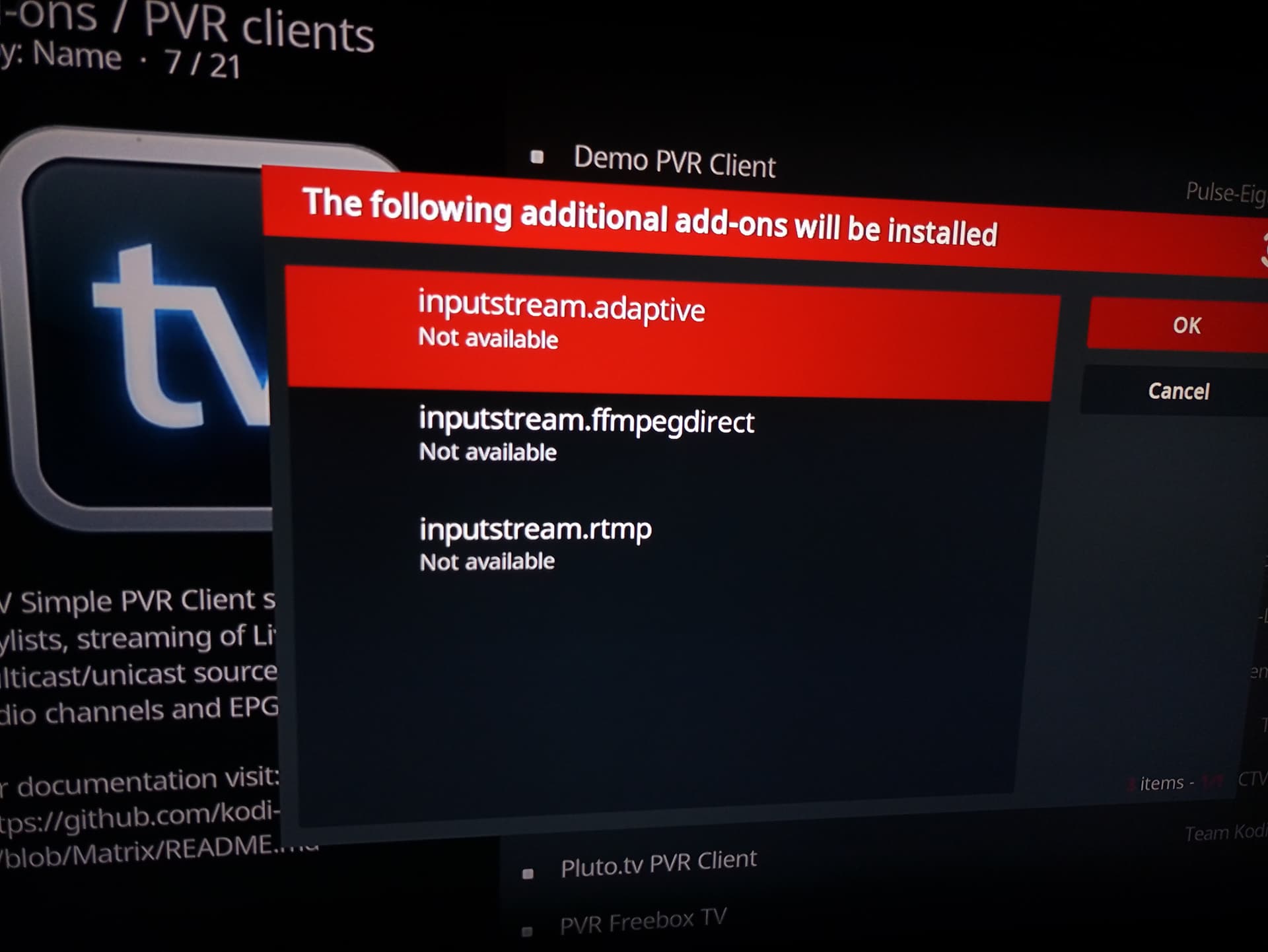

No one answered me about the lack of InputStream Adaptive on 22 CE. I also tried searching for a zip version to no avail and there is no repository available.
I found this link but it didn’t solve the problem
Input Stream it is a plugin and has nothing to do with ce itself. Compile your own and try it out.
I thought it was available in the repository at least, so it is important. Can you point me to a reference for the configuration? Are there specific conditions for the configuration on CE?
All addons should be available. If not refreshing the CoreELEC repo is needed.
Update with nightly and soon there will be alpha2.
Sadly we can’t keep all old addons and seems something is off between alpha 1 and nighlies and soon alpha2.
