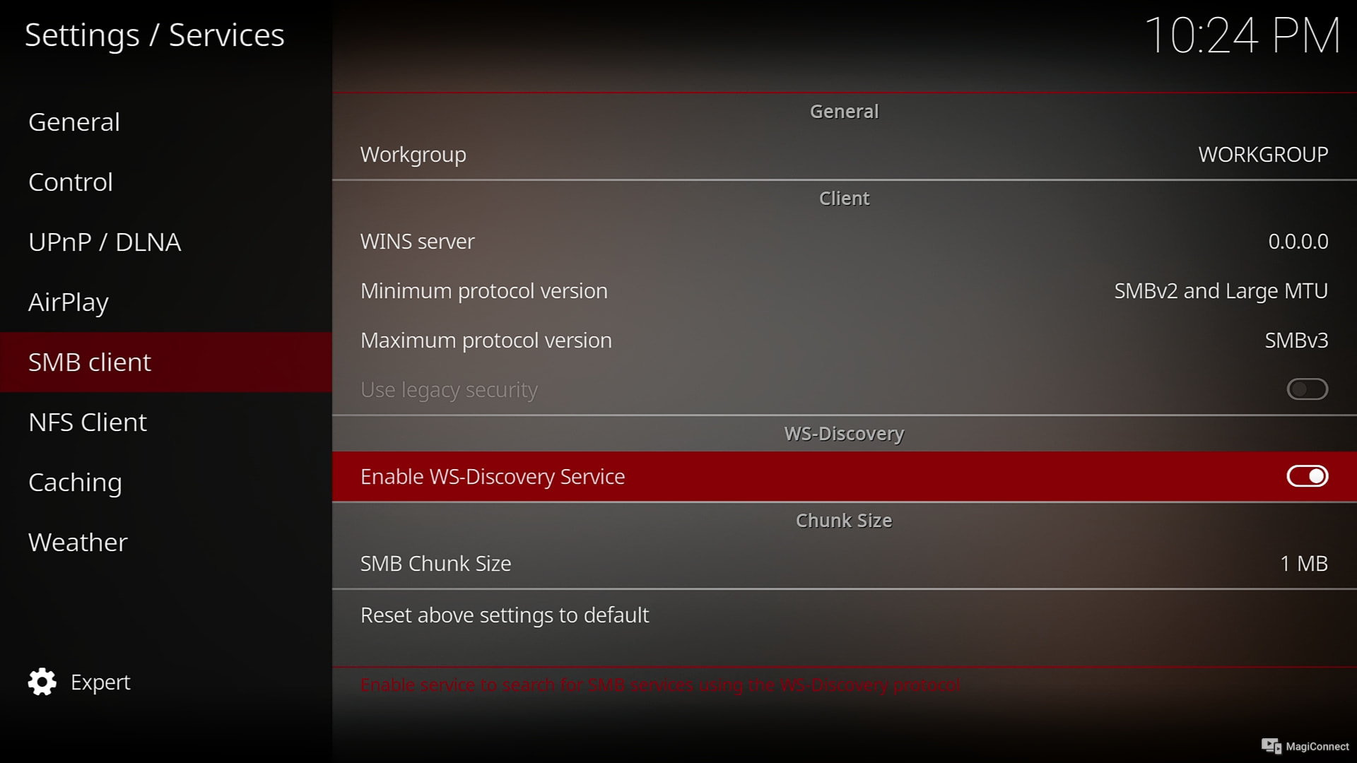

It is going, but on ce22no device and shared drive is needing set smb v1 for succes identification and pairing.
No issues, since long time.I have older dedicated laptop for smb share Win 10 ,so ihave to set minimum protocol 2 max 3
and dont forget WS discovery..
on clean install maybe this is disabled/ default
