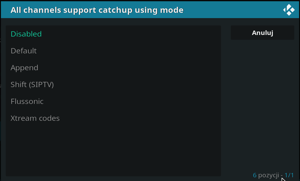

They did great job. You can force various formats in addon settings:
Or it can be defined inside m3u. I’m not sure about other formats, but for Flussonic it’s defined by catchup=“flussonic” property

This build includes a similar configuration to the Matrix addon, and should work in a similar way.
You select Default to use the catchup defined in the m3u8 file, or select one of the archive types you want to force it to use that type.
