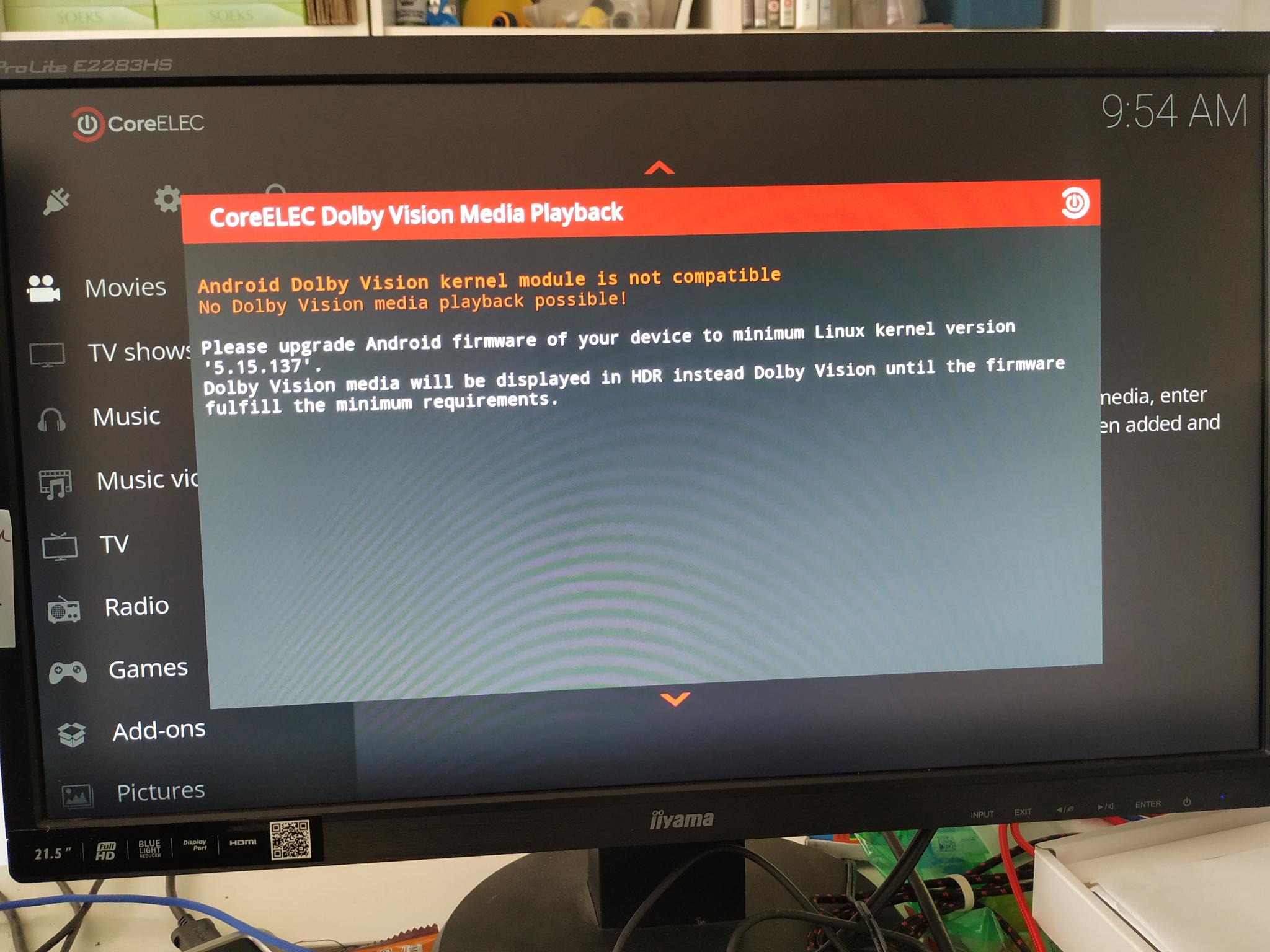

I know you all think I am an idiot, and I probably am because I do not have the same skills as you guys. I installed Omega 21.3 and was told I could get no help because it had reached EOL. The only way to get support was if I installed Piers 22.0 beta1. I did that and posted a photo of the problem on start up. Freddy says I may have the wrong DoVi.ko file, so I asked for a link to the right one and got told to search the forum. I cannot find the DoVi.ko file that you claim nobody is having any problems with.
Thank you. I will read it. I just installed that file and can confirm it now starts with no message. The curious thing is that the patched fix file is one third the size of the one I had previously.
