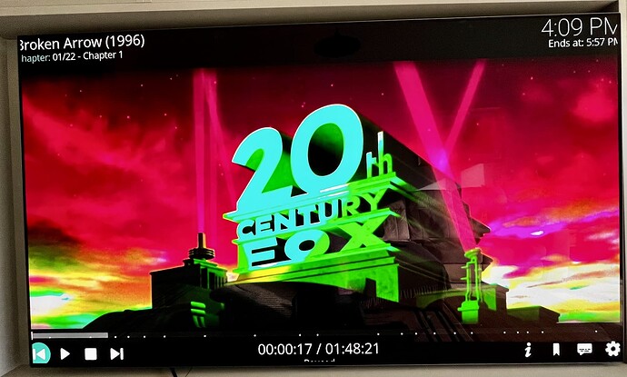

CE updated to Amlogic-ng.arm-21.0-Omega_nightly_20240315 this morning and the colors are very unnatural now. This a very obvious one…
VS. v9.2.8

okay, managed to hook up the device directly to the TV and the result is exactly the same.

Broken arrow has only ever been available in 2K. Playing 1080p SDR content at 24hz should be problem free. I think Something else is going on with your setup. Like a TV setting or possibly you marked the wrong forced cs/CD option.

if I just take the HDMI cable from back of the U22 and put that in back of U9-H (where v9.2.8 is running) everything is perfect without changing anything at all. I just did a brand new install of stable 20.5 without changing any such settings, before taking the picture.

Btw the default cs/CD switching logic is currently coded (ie still in official code, the fix I tried alters this), to set 12-bit YUV444, at least for 24hz content. Seems that gets triggered with both HDR and TV-led (which just so happens to mostly work because for some odd reason you have to set YUV444 as RGB 444 results in a black screen for TV-led).
I’m thinking that is the behavior you’re seeing, and not due to your sound bar?
Also I tried my Sony TVs and hd Fury a second time. Not sure why they more consistently resulted in 8-bit RGB but less occasionally they also triggered 12-bit RGB. So it turned out to not be isolated behavior to my LG TV setup. However that LG TV has a receiver in-between so that might be why it did it rather consistently and only rarely correctly set to 8-bit.
It doesn’t appear like you enabled HDMI Deep Color on that port and/or on your receiver.
You can see from the dispinfo you posted that there’s no clocks over 300MHz supported.

Is there any deep-color setting in CE? The AVR and TV settings should be okay as it’s configured that way for months/years now and my U9-H was connected on that port. I just connected the HDMI from U9 to U22.
However, I have a theory now: I have Omega_nightly build on a USB stick and 20.5 stable on a Tf card. if I swap the media without going through pressing the recover button etc., looks like I get the wrong color. I have to try that a few more times to be confirm.
