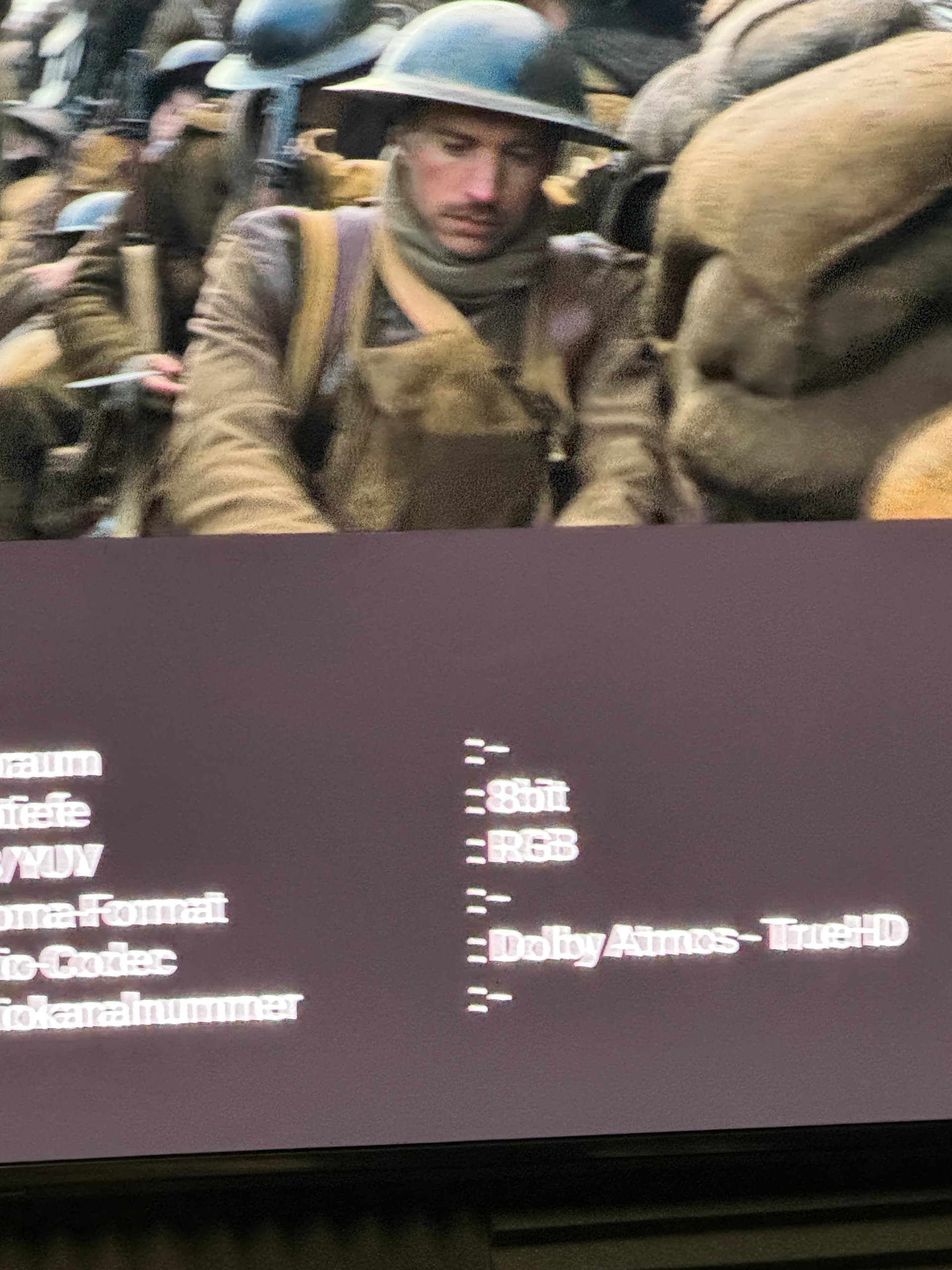

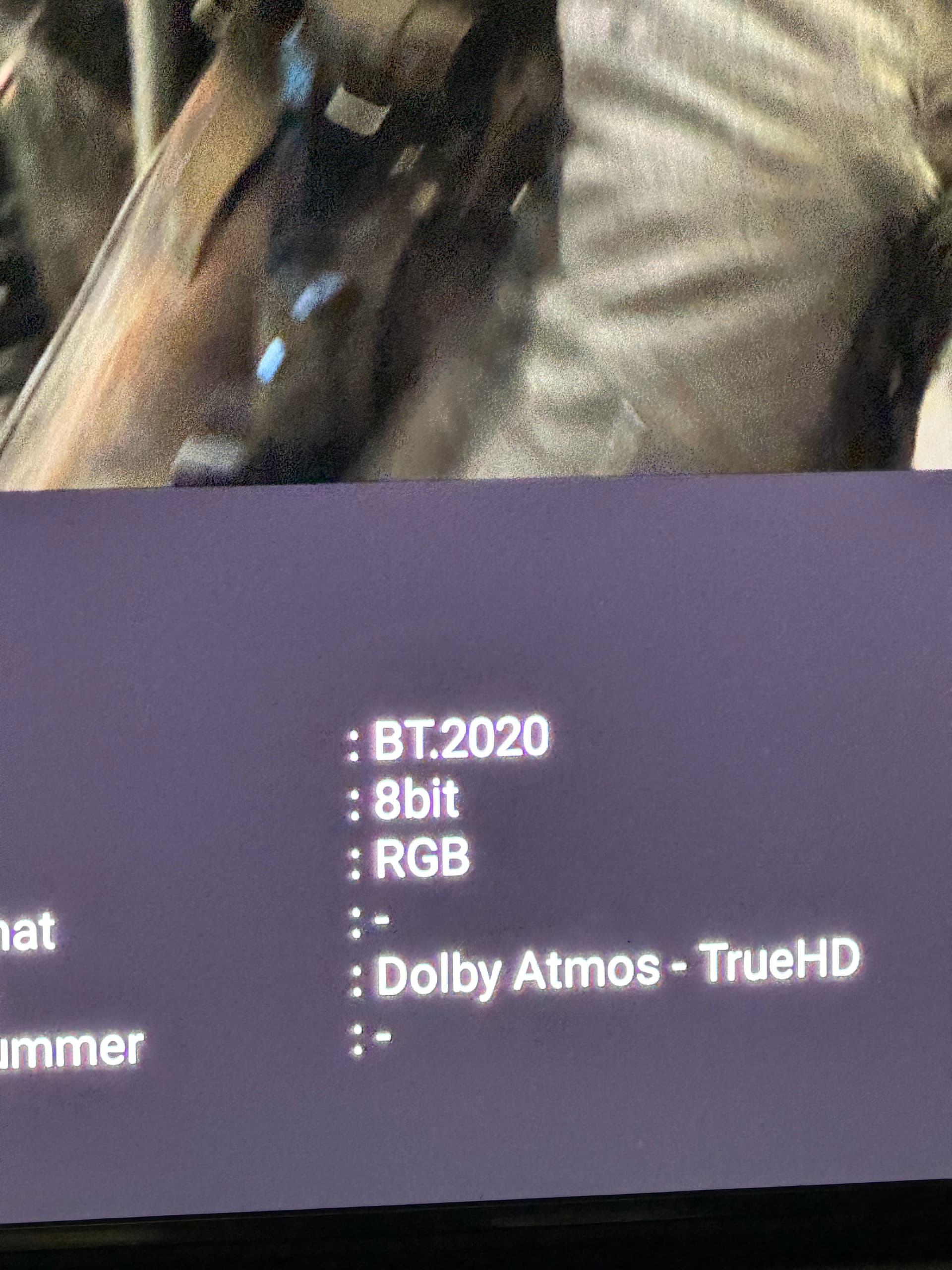

Edit: just installed latest nightly and tested it out with my Sony TV (A95L 2023 QD OLED). Colors and brightness looks the same and my tv shows BT2020 when flag is enabled. When it is disabled, no colorspace is shown on the info screen. With my Zidoo it showed BT2020, too. I think the BT2020 flag enabled is the better variant, as my tv shows no colorspace at all if the flag is not set. Picturewise it makes no difference,but it just seems wrong if no colorspace is shown on the info.

I think the BT2020 flag should be set. Maybe a menuoption could be integrated to change it if needed. It seems at least the newest sony tv uses Bt2020 and stays in it, even if the flag is taken off.
