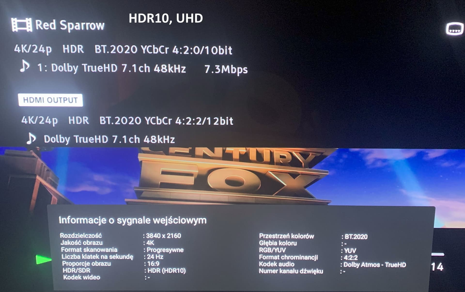

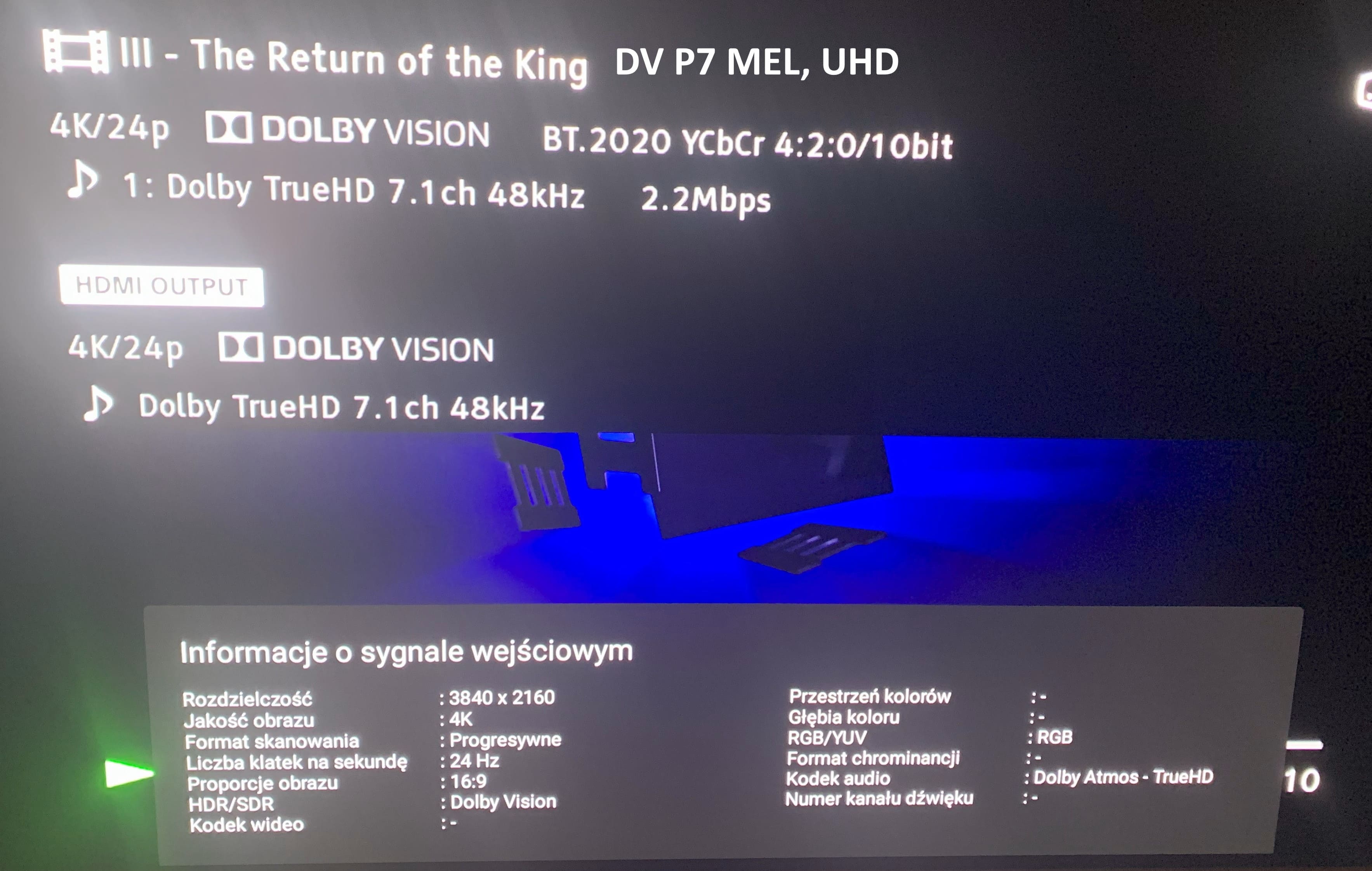

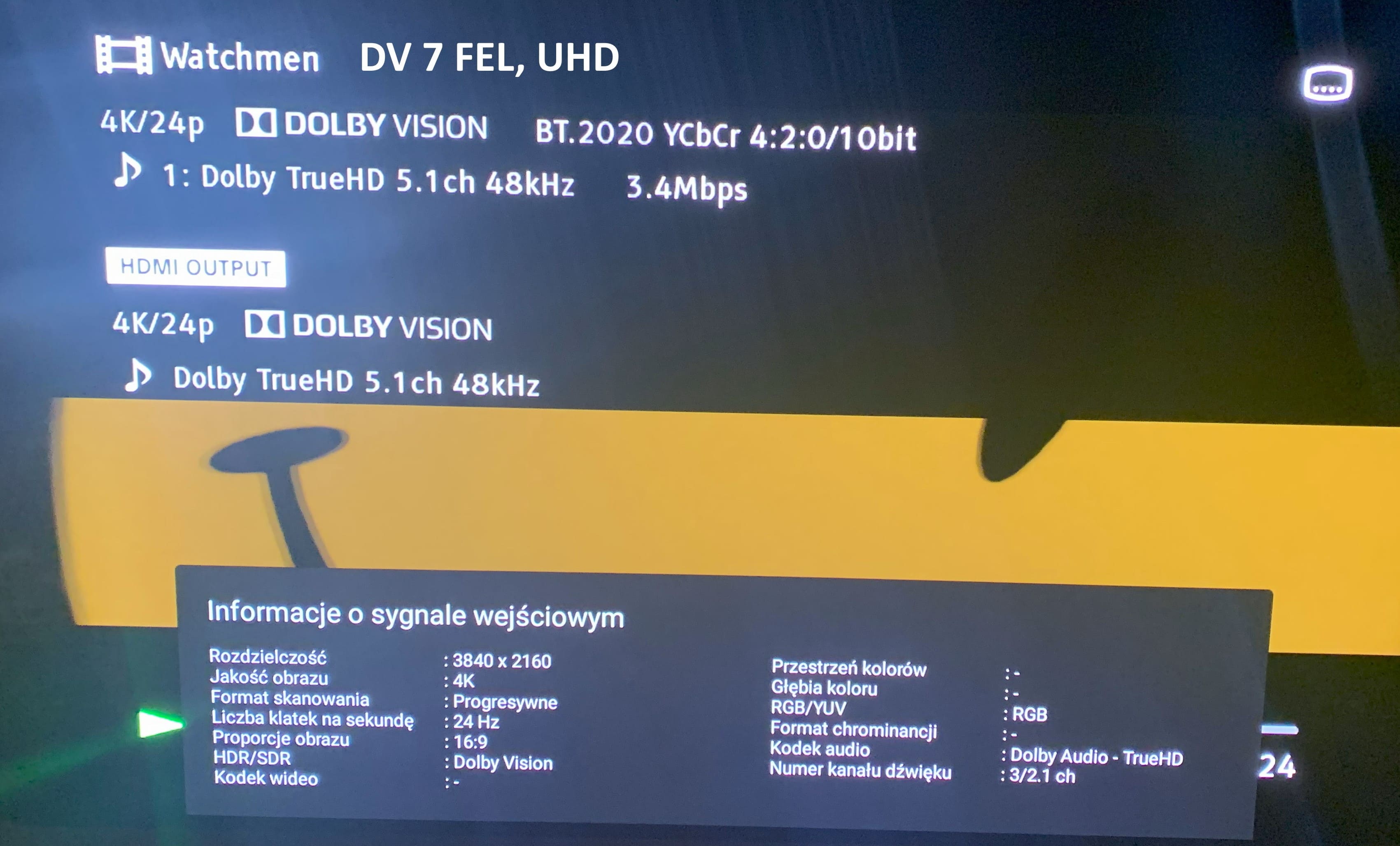

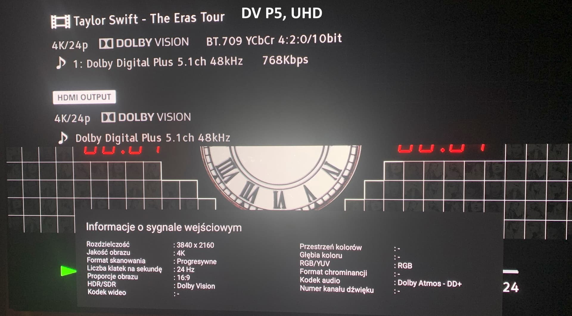

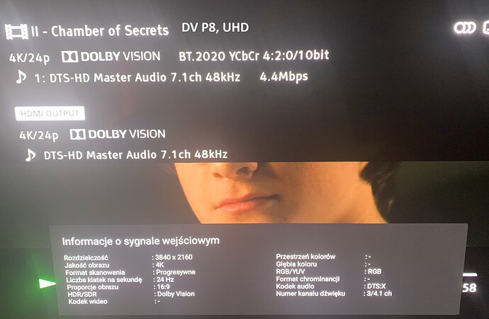

SONY A95L + SONY x800m2:
  • any DV profile (P7 FEL, P7 MEL, P8, P5): no color space, no color depth, no chroma, RGB
  • HDR10 (UHD): BT.2020, no color depth (?), 4:2:2 chroma, YUV
  • SDR (FHD): BT.709, 12bit, 4:4:4 chroma, YUV
So I think BT.2020 shouldn’t be set. Moreover, the color depth should not be set either.
Maybe it’s the 8bit color space combined with the lack of BT.2020 that causes the color saturation problems?
DV P7 FEL, UHD:
DV P7 MEL, UHD:
DV P8, UHD:
DV P5, UHD:
HDR10, UHD:
