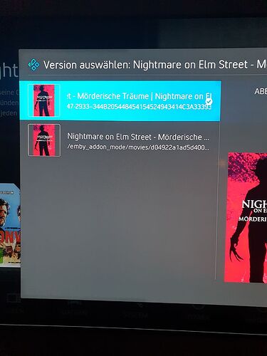

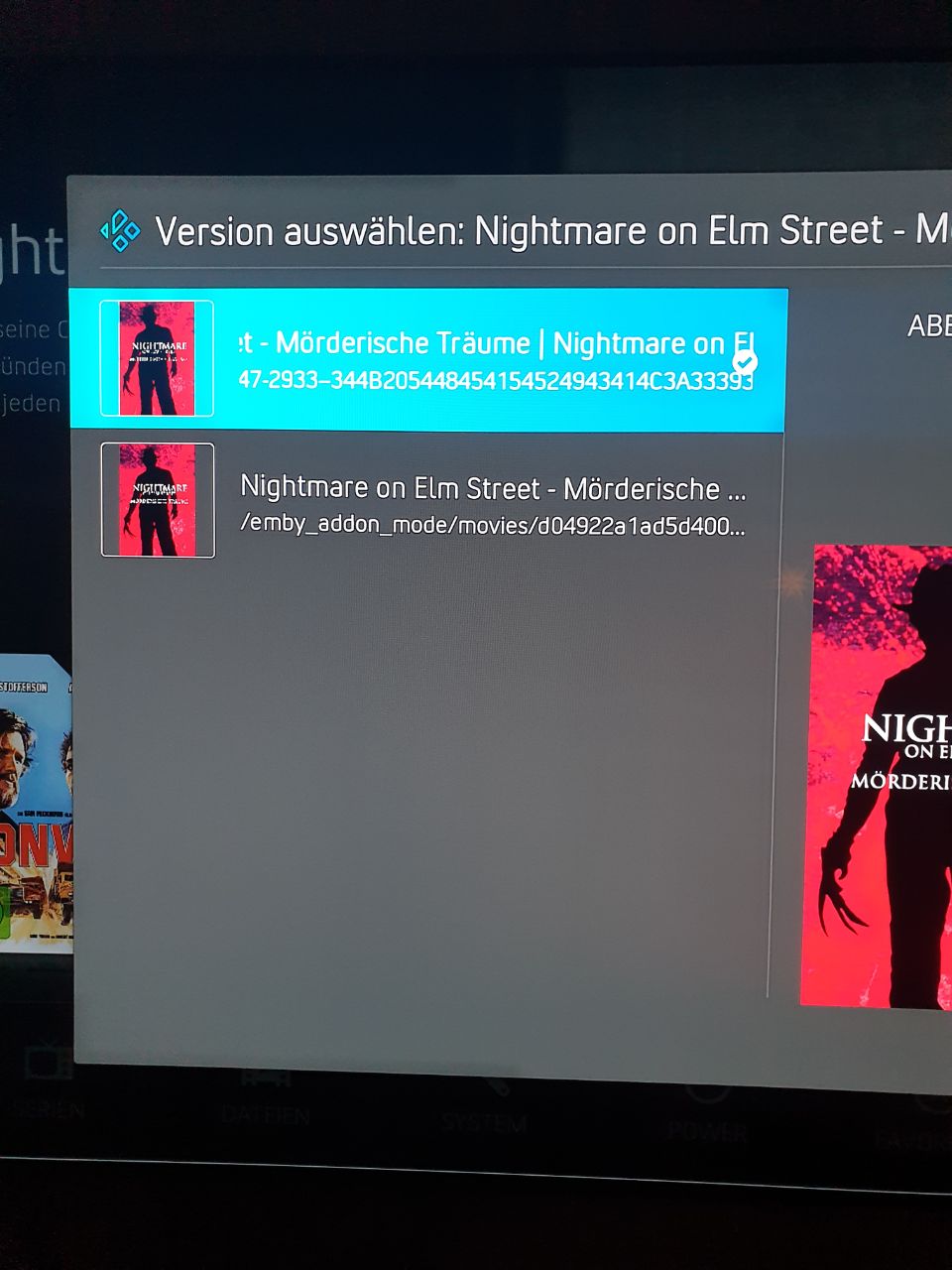

Hello jamal2367. Thank you for your work on that skin, but I’ve found some issues that I’d like to point out to prevent them from becoming more significant. The edits made in the file DialogSelect.xml from version 17 are causing errors, which I’ve attached as images. You can test this, for instance, on widget customization for the home screen, etc. This error also appears in add-ons that use this XML file to display certain information. When I replaced DialogSelect.xml with the version from 16, everything worked as it did before.

Did you have tried Release 17.2?
This fault is happened with 17.1
Make sure you have install the latest 17.2
I’ll check the font.xml later to make sure it’s available everywhere.
I’m sorry, my mistake. I had version 17.1. After installing version 17.2, DialogSelect.xml works correctly. Thank you. I’m looking forward to further updates and improvements. :slight_smile:

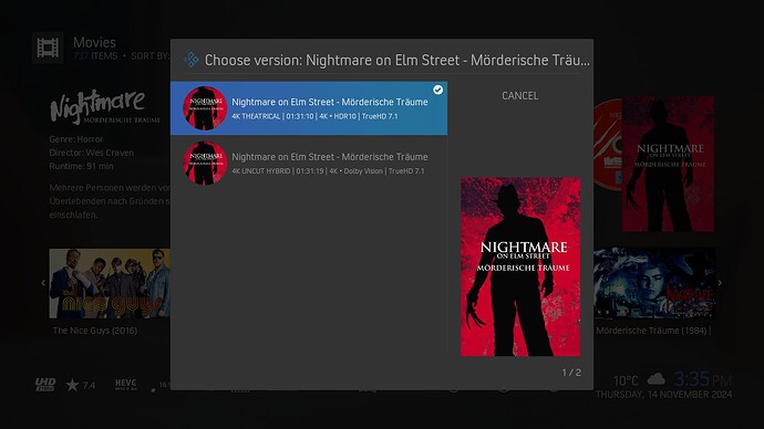

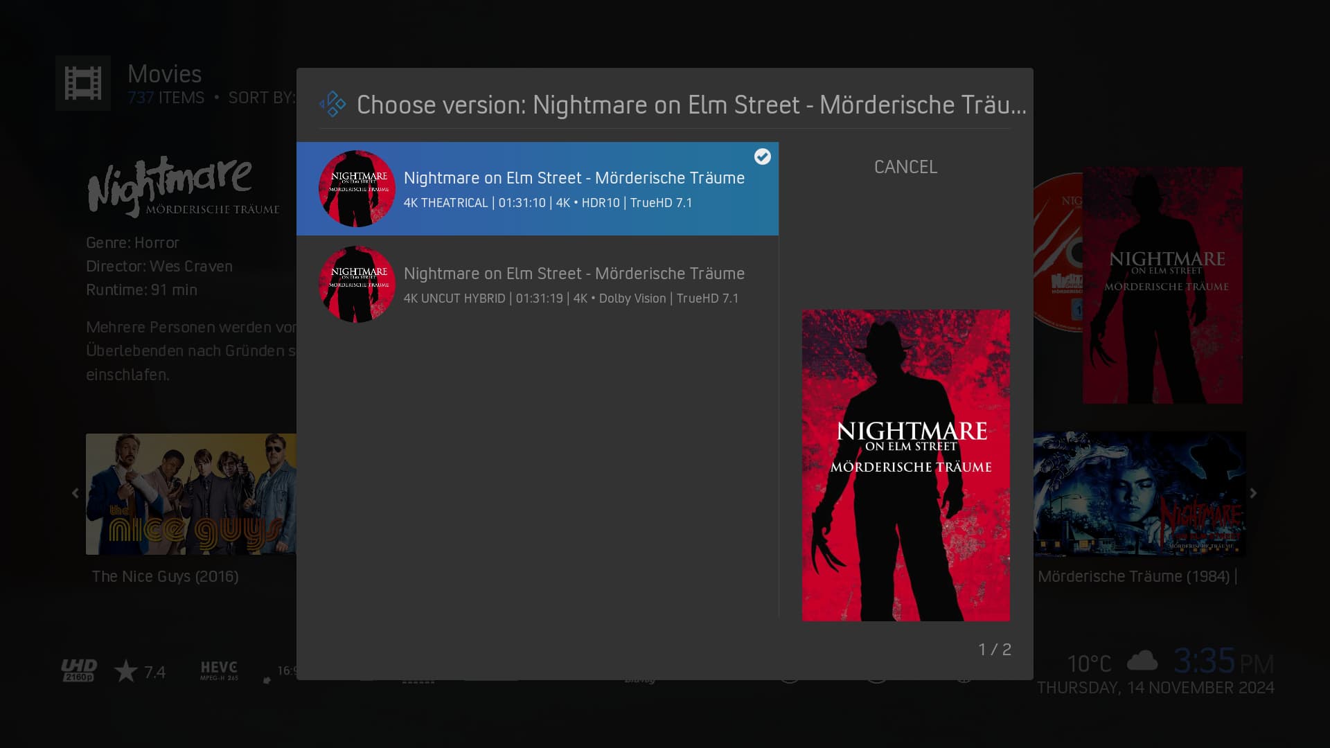

The change of the SelectDialog.xml was made because of the version selection e.g. for the Emby Next Gen or other Addons.
You can see it very clearly here (Release 17.2):
With Release 16 it’s looks. :nauseated_face::face_vomiting:
I understand. I saw those tags in the XML that are supposed to display this information, but I didn’t have a chance to see them while using it. It definitely looks great, and I’m glad for this update. :+1:

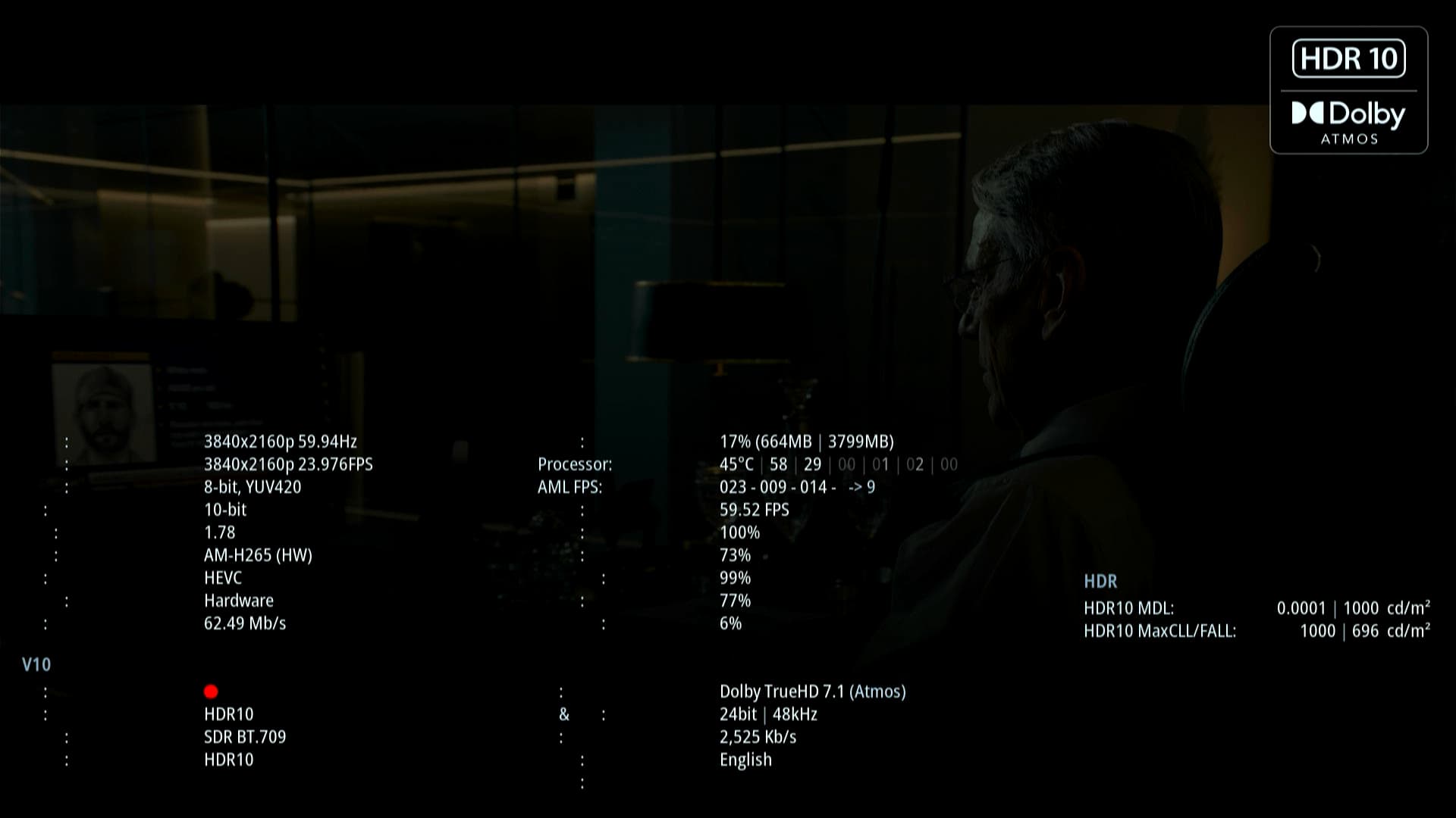

Changes from 17.2 → 18.0:
  • All existing font issues fixed.
  • The skin can now display Cyrillic characters correctly.
  • Unused fonts have been removed.
  • The separator lines in the PlayerProcessInfo now have a different color for better visibility.
  • Added background layer for codec logos in PlayerProcessInfo for better visibility.
  • Added background layer for codec logos in Video OSD for better visibility.
  • Now use the correct name for the conversion from SDR and HDR to DV.
  • Some alignments in the PlayerProcessInfo have been adapted.
Screenshots:

Hey, you’re reading my mind! I was actually thinking of suggesting that it would be great if those logos in the top right corner had some kind of background for better readability. And now I see you’ve already added it. It looks fantastic! I can’t wait to get home from work and try it out. Thank you!
That really makes a big difference.
It already looks good in the screenshots, but it looks even better in action. :smiling_face:
The PlayerProcessInfo screen looks amazing.
