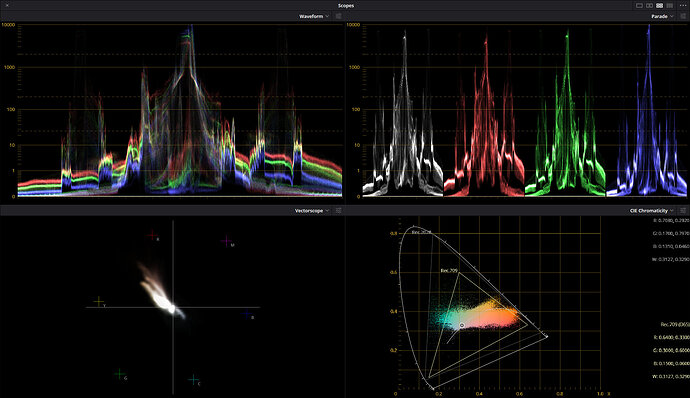

Hi, currently doing the vs10 tests. Found a glitch, CEAM when converting to SDR from HDR(DV) incorrectly compresses the color space, it turns out to be larger than bt709.
Dune players for example compress more correctly, almost do not go beyond bt709.
Can this be corrected?
