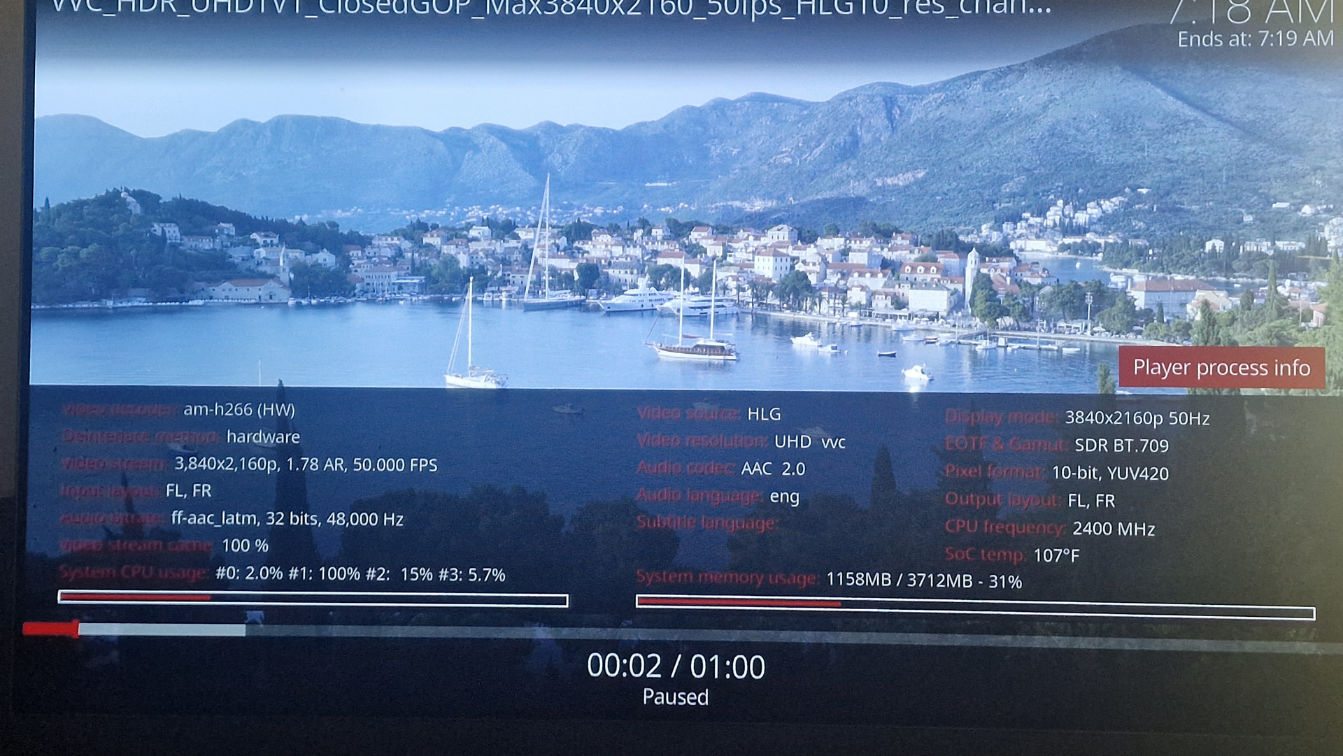

I was unable to trigger HDR from this video,it should be in VVC I guess.

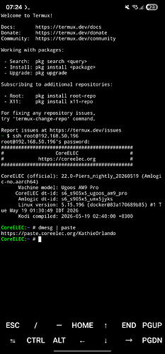

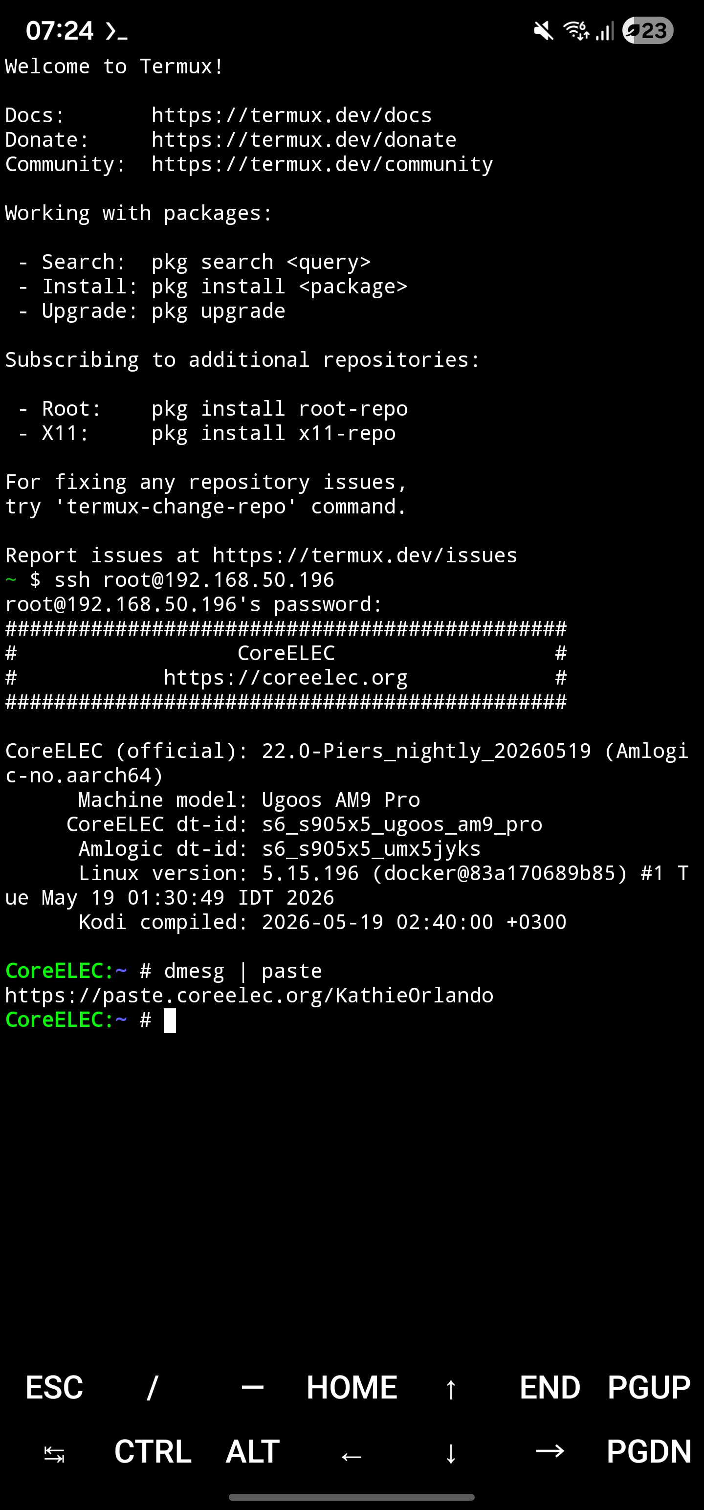

Another way to get logs,maybe it would be easier for most users.
Enable ssh in CoreElec
Download and install termux on your android device
In termux type
pkg install openssh
Type this in termux,change it to your CE device IP
ssh root@192.168.50.87
default password should be coreelec
then paste log
dmesg | paste
It should give link with logs

VCC HDR is not yet working.
