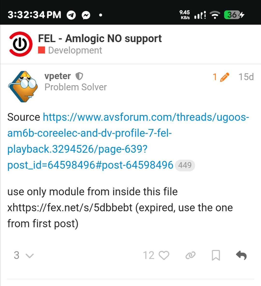

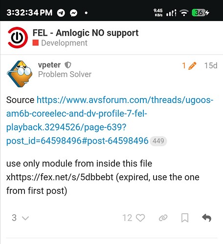

Did you even read first post? Link is there.
Where?
:cold_face:
Unbelievable!
neqwdtkukwjaanti told you where the images are.
