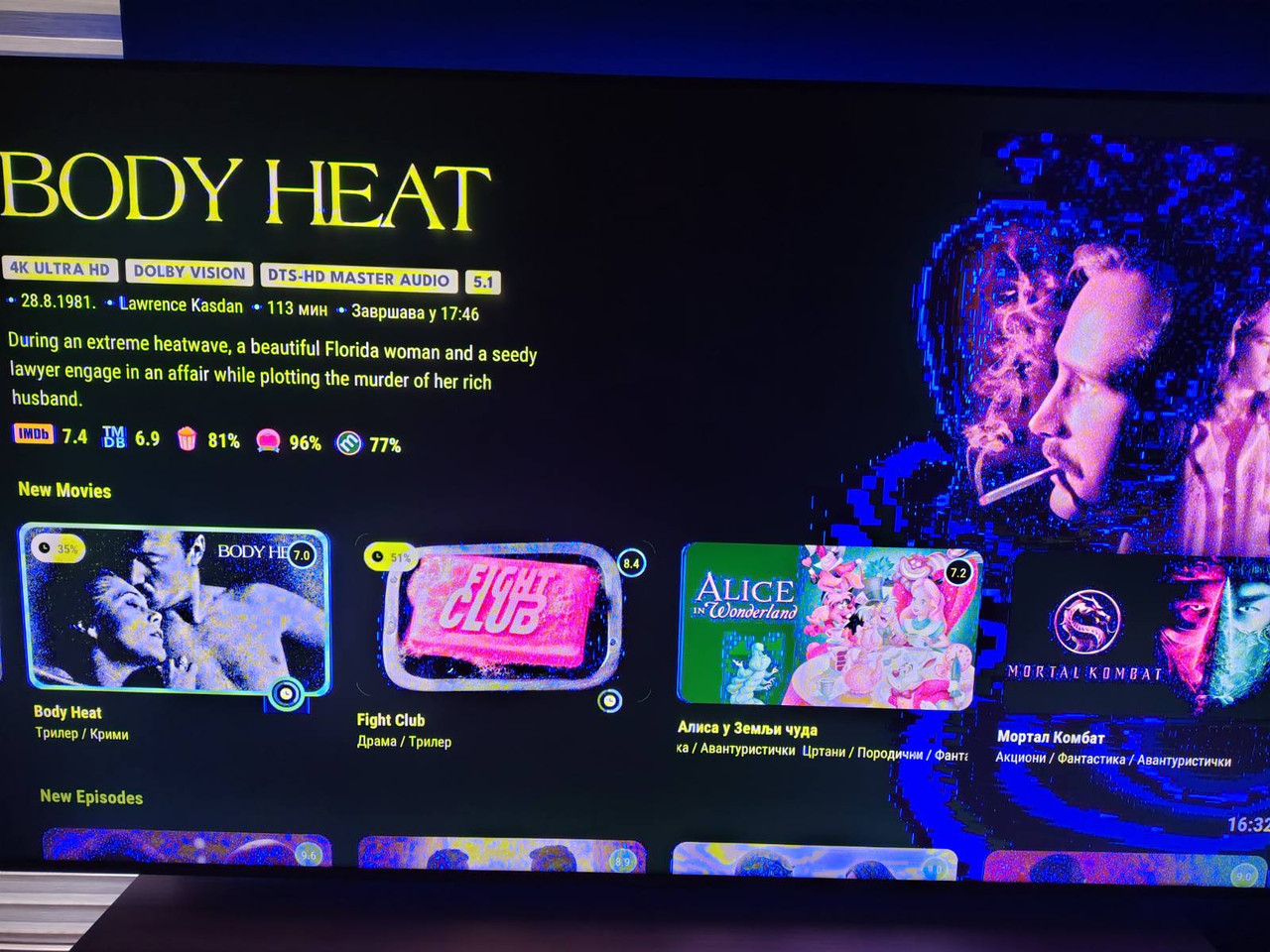

Hi, yesterday I installed 507 build (updated today to 509) and used latest dovi.co file. FEL forks perfectly, however I didn’t tried to watch whole movie, just part, seek works great, audio sync is perfect also.
But, I have problem with sdr to hdr conversion. sdr to dv works perfectly, but I never like that conversion, since colors on my tv looks off (too much yellow and grey)… Anyway, when I put sdr to hdr tonemapping, after a reboot I tried some sdr material, and got black screen. I forgot to mention that I use 2160p with disable gui scaling. I got black screen on sdr and hdr stuff, but on dv it works. I tried to reboot, and its the same. So, I tried to lower resolution of gui, and put 1080p and in that case, sdr to hdr works, hdr works, dv works, but when I play dv materijal, and after close the video, I got screwed up gui, colors off, mostly in blue… and after that I can only play dv material. sdr, hdr looks off, like gui (I can screenshot it if you guys need it). So, is this bug, or something I haven’t install like it suppost to be?

After many tests and reboot, I’ve found the error.
The same movie that show SDR on Video source type , I just need to open 2nd time , to change the SDR to Dolby Vision.
This not change the color only the SDR to Dolby Vision, I’ve look over and over to see any difernce on SDR appear, is the same with Dolby Vision appear.
And I provide screenshot of screen after I close DV file in hdr gui.
