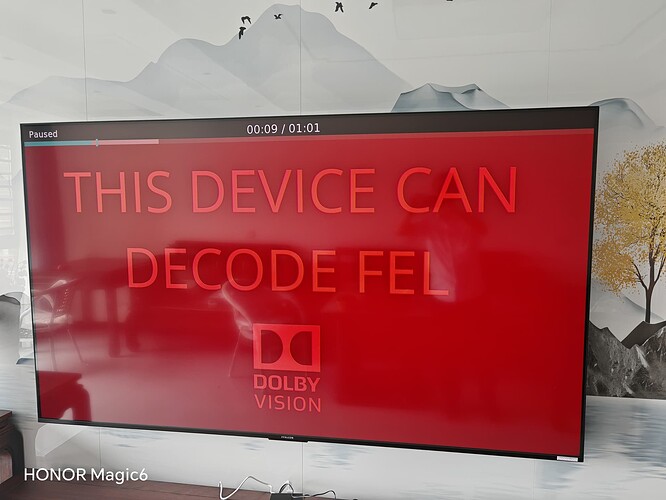

Fel s905x2
s905x2-k and s905x2-j share the same code g12 like s922x-j ,under tested both s905x2-k and s905x2-j can support fel.
but cannot support cmv4 ,only cmv2.7
some chinese pro use x96 max.replace s905x2 with s905x2-k,the machine can play fel.s905x2-k在ce下也是可以双层杜比视界的【coreelec吧】_百度贴吧 that’s really awsome

Mecool KM3 replace S905X2-K CoreELec cpm build ok :slight_smile:
