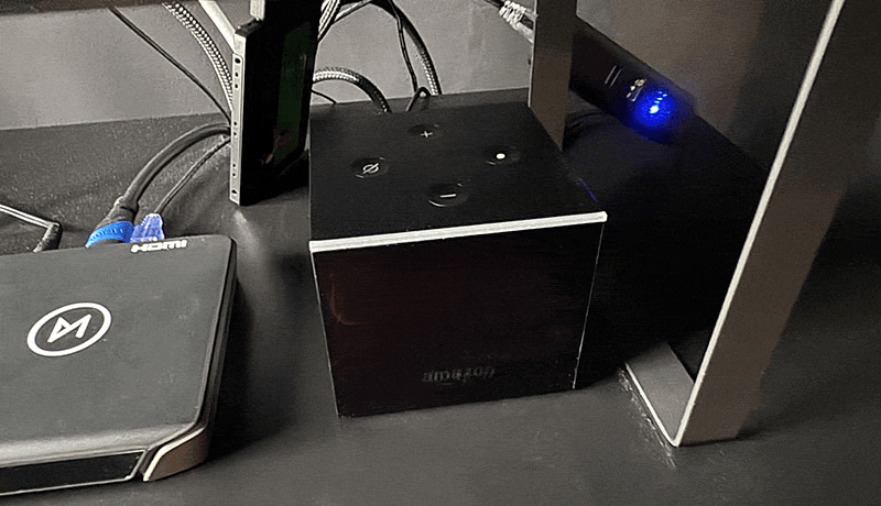

Cube 2 still seems like such an underrated, underappreciated (and IMHO better) Ugoos AM6B+ alternative :). Maybe preaching to the choir here… just did a video to show anyone hesitant to try rooting that it’s now pretty easy:
Better than AM6B+ :slight_smile:
