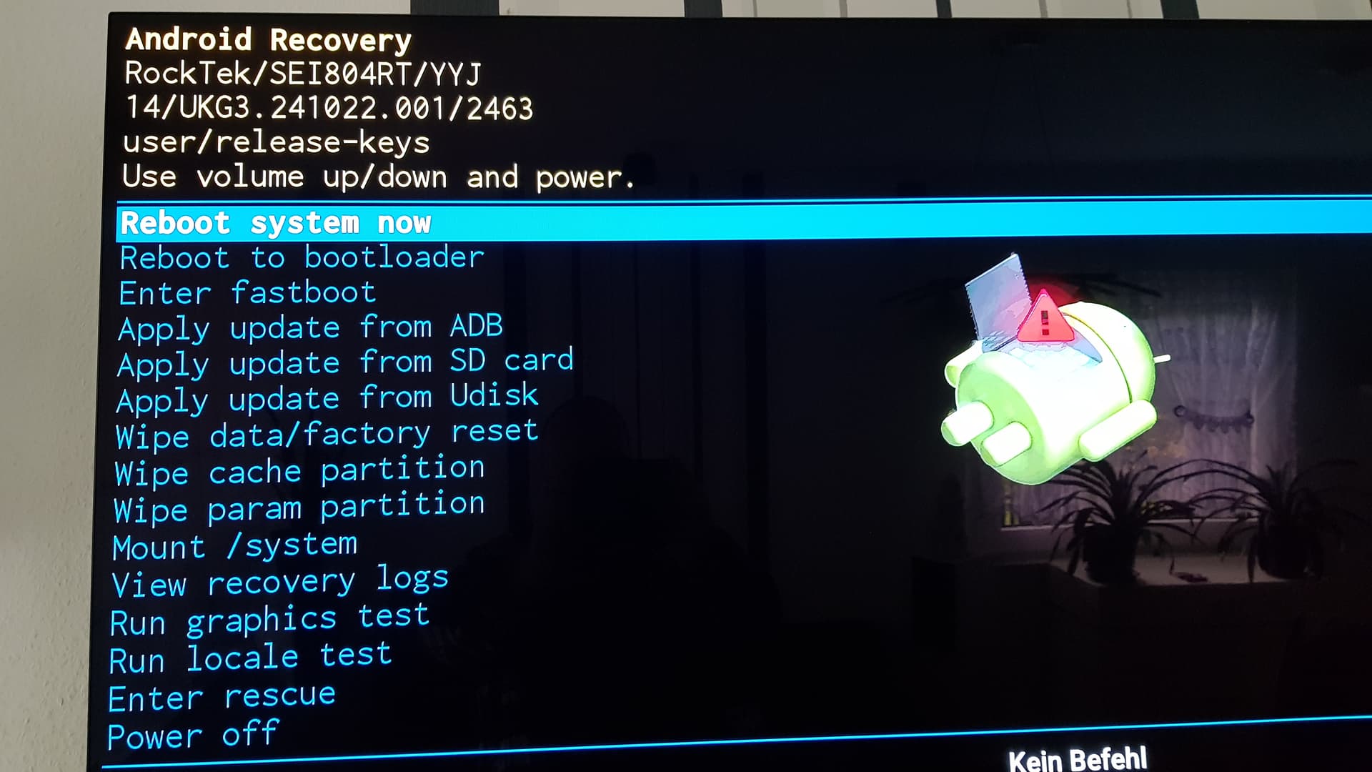

I can’t get CE to run via usb does anyone have any advice ???
I did the same as in the guide, tried both usb ports via reset and no CE loads ???
this is displayed: Fastboot - Press reset again to enter recovery mode
if you press the reset button at the bottom of the usb 3.0 port this appears:
I don’t know what to do now please help
Are you seeing this right after upgrading to ATV14?
Search the forum for Homatics, USB and modifiy. USB get powered off on suspend. Use power off.
yes , I don’t know what to do now please help
It’s bug with ATV12 or with CE NE? Before then it’s worked with ATV14 and CE NG fine. Or should i downgrade it to ATV11 or should I upgrade it to latest ATV12 beta?
You should downgrade to ATV12. ATV14 work only with CE NG or with CE NO. CE NE work only with ATV11 or ATV12.

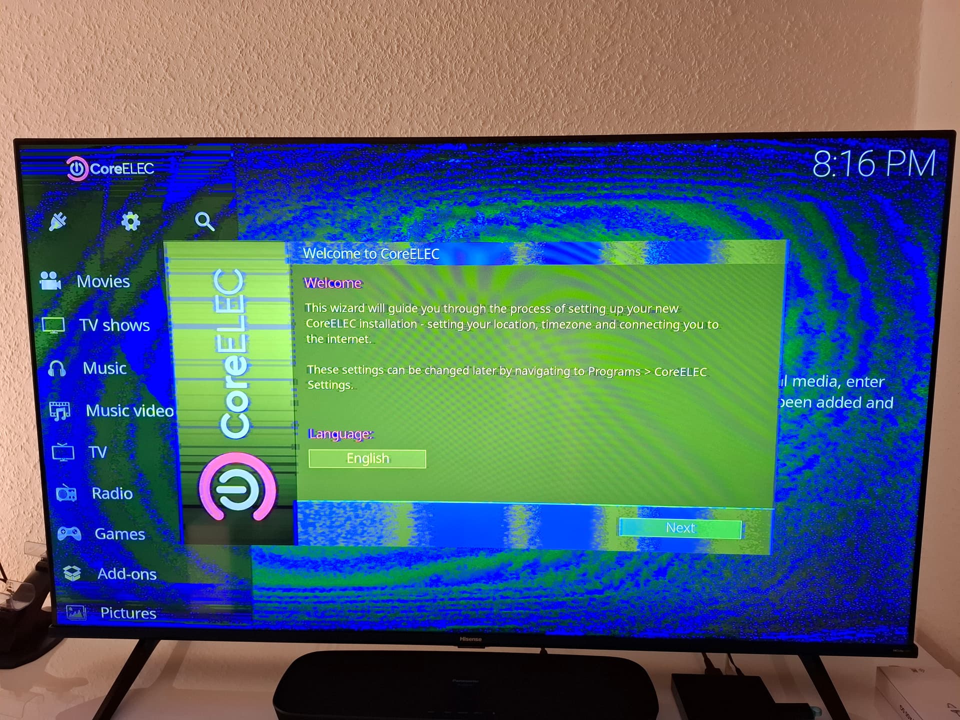

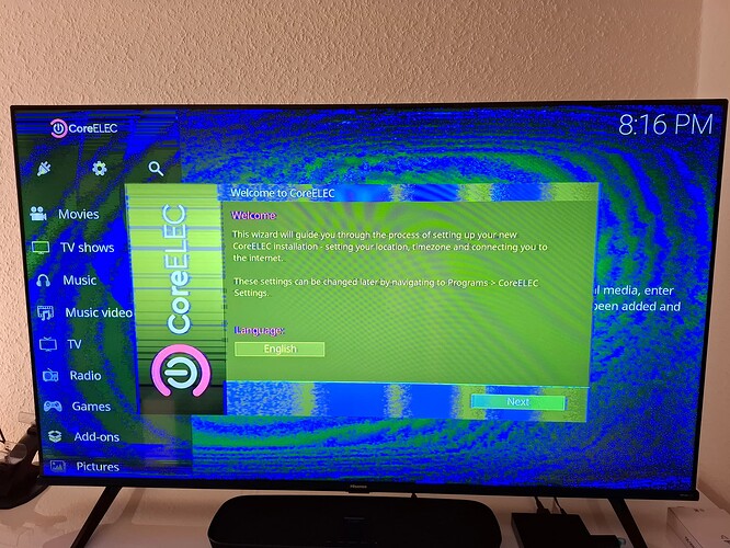

When starting up the image is green, see photo. Still running latest nightly.
