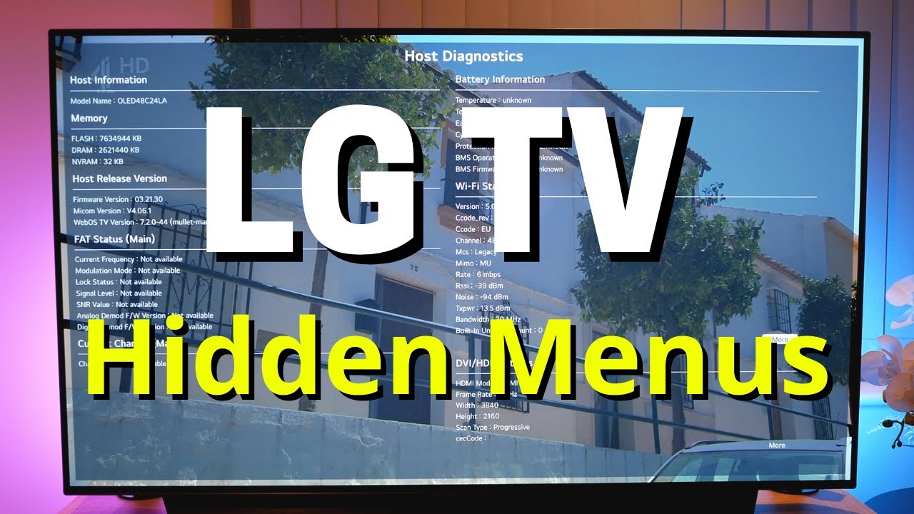

By the way, I tried to set forced RGB, in this case I get a black screen even with player led disabled. I’m not sure which subsampling gets selected with auto (don’t know how to check, tv is LG C1).
So I guess it’s back to keeping player led disabled and subsampling set to auto for me.
I’d suppose the Kodi log would also show what is being output.
Thanks, I tried looking for this hidden menu some time ago, but maybe I used the wrong combination then. So now it worked for me and I see RGB mode, on auto subsampling setting. Still, if I choose forced RGB mode, the screen is black (though dolby vision logo appears).
Anyway, this doesn’t change the fact that color banding is more obvious when using player led and 4:2:2, compared to disabled player led mode and subsampling set to auto. (on an LG C1 tv)
