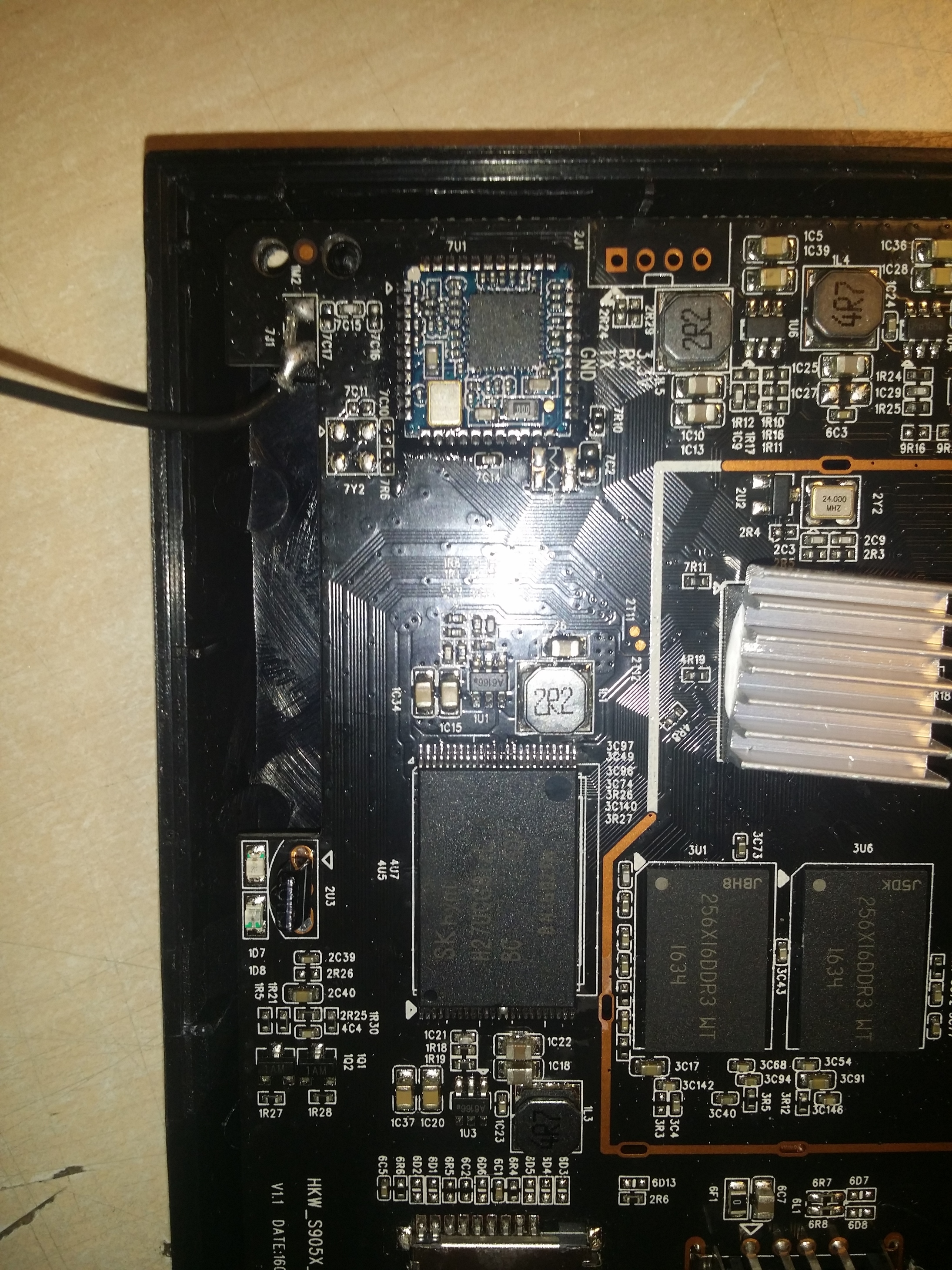

Ok, I try to ask another question. On the Box is written M96X is a S905X with 8gbrom and 2gb ram. The probla I think is in the flash and is a h27ucg8t2etr of Hynix (http://www.datasheetcafe.com/h27ucg8t2etr-datasheet-64gb-mlc-nand-flash-memory/). DI Ip scanner the manufacturer is ICA Inc. and I do not know who it is. I attach photos.
The problem is that your device uses a raw NAND IC instead a managed EMMC module.
Raw NAND requires that the flash content needs to be managed by the CPU by SW. I doubt that this is supported by CE.

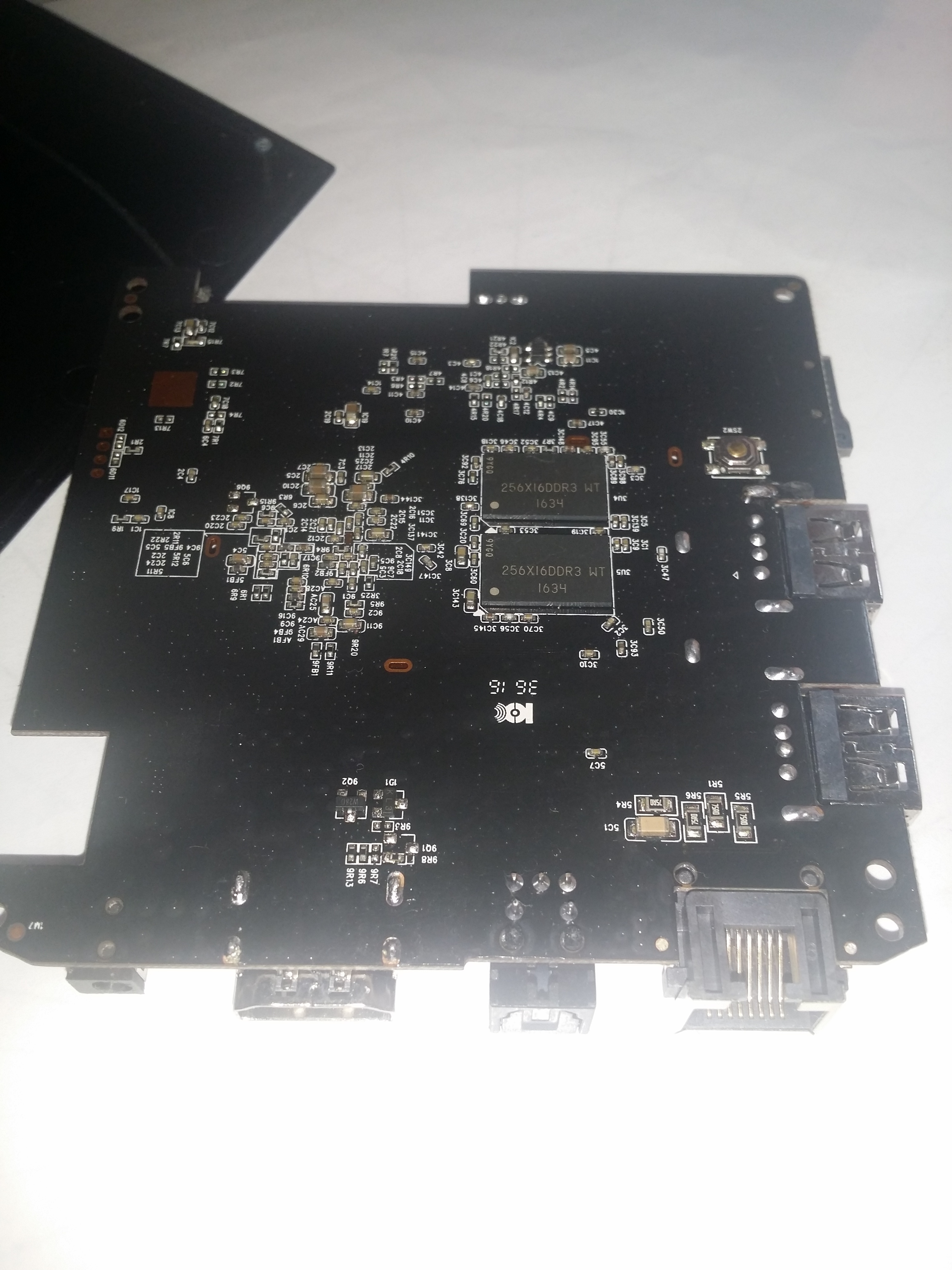

[EDIT] Maybe you can share a pic of the bottomside of the pcb.
Sure. No problem. But now he saw that something is not right. On the device I have 4 ram chips that seem to be from 256bg each for a total of 1GB of ram. However, the system sees about 2GB. Even when I used it with android, it saw 2gb of ram. When purchased it was sold with 2gb ram installed.
You got a box with “fake RAM”.
It really only has 1GB of RAM, and you should be using the 1g DTB on CE.
Ok and why work well the dtb file with 2gb of ram? If i use the dtb with 1gb ram i don’t know if works.
