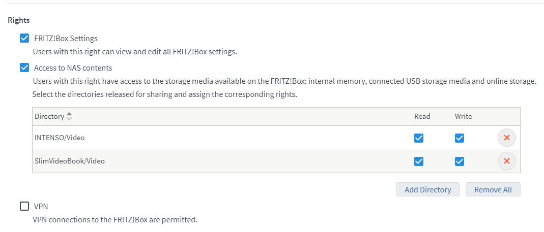

Here are the sharing rights / settings for this user:
fritz-user1
