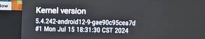

Edit, this moded FW still shows the same Android FW version as original 11.1.4, but as corrected by @hungphutho Kernel version is from 11.1.13.

No, Shows as 11.1.4 but based on 11.1.13.
Because I want to check if the update is really blocked.
Look at the kernel
Thnx, corrected in original post.
