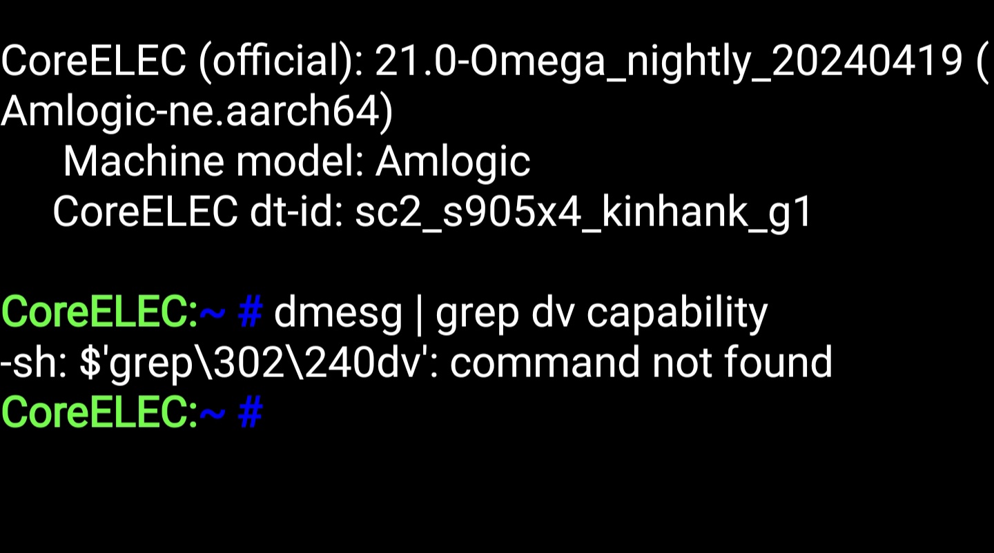

Should be dmesg | grep dv capability
Here is result
https://paste.coreelec.org/pmcKEP

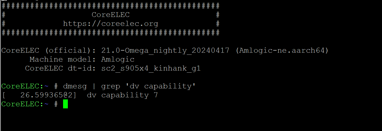

***Bot is editing the line you need this symbol/character
( ` ) before and after dv capability with no space
Come on :thinking:
dmesg | grep 'dv capability'
or
dmesg | grep "dv capability"

Don’t copy/paste images if you can just copy text!
CoreELEC (official): 21.0-Omega_nightly_20240419 (Amlogic-ne.aarch64)
      Machine model: Amlogic
     CoreELEC dt-id: sc2_s905x4_kinhank_g1
CoreELEC:~ # dmesg | grep "dv capability"
[   14.575837@2]  dv capability 7
CoreELEC:~ # dmesg | grep 'dv capability'
CoreELEC:~ #

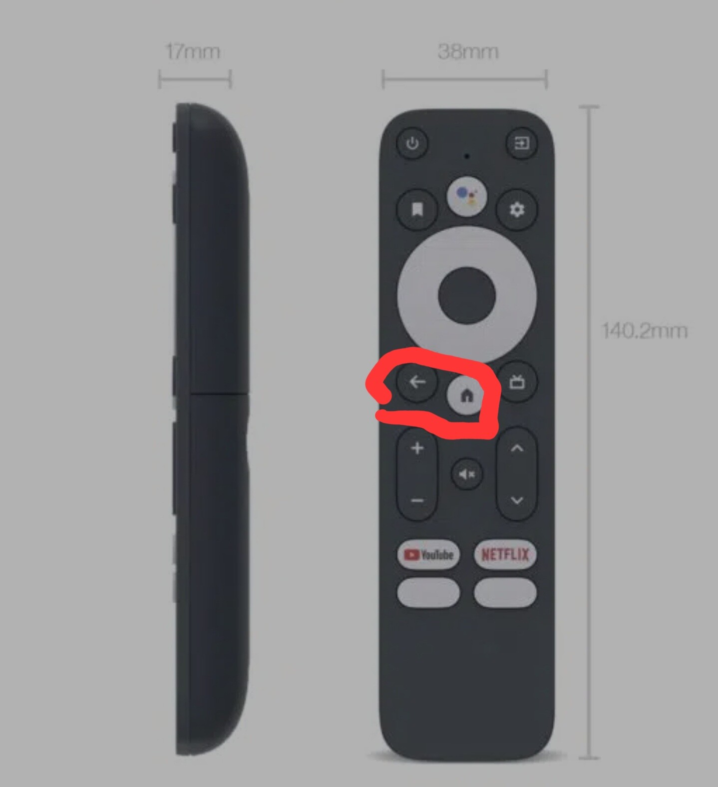

also remote G10 not connected BT correct if run back & home in same time
Dont understand run back and Home???

So back button/ return is working for me
Home button when you click on can here sound from UI
But does not return you to Home

I mean, press the two buttons at the same time for a while until the remote light lights up green. This is the Bluetooth pairing status of the remote.
