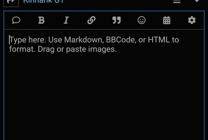

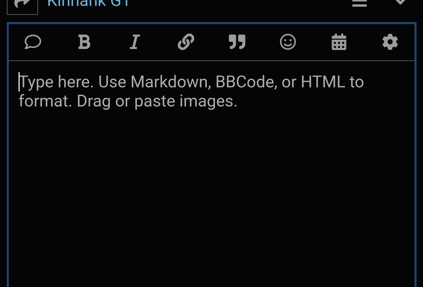

People, please start using code formatting when posting content from terminal.
sorry,
but option not apper if use mobile
Set code around triple backtick ``` characters.
