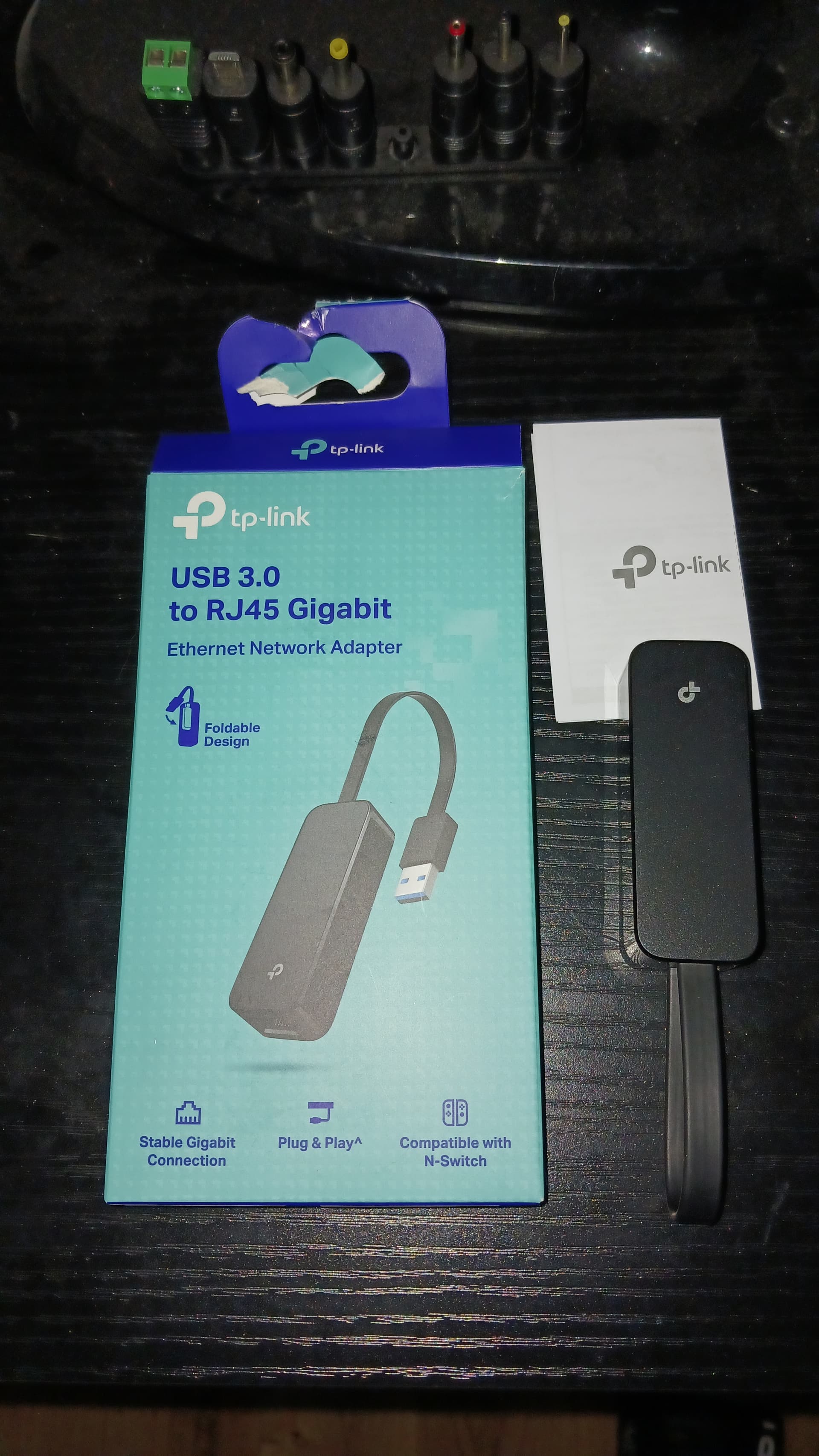

For those dissatisfied/ unhappy with 100 mb Ethernet
Can confirm TP Link Gigabit USB Ethernet Adapter
Model UE 306
Works great on Kinhank G1
Just plug n play !!!
