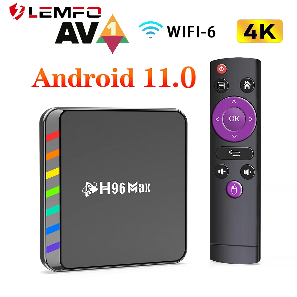

Hi guys.
I’m considering to buy a H96 Max W2, since it’s the only TV Box I found with the S905W2 SoC and WiFi 6. It’s also very cheap at around 38 euros for the 4 GB of RAM and 64 GB of internal storage version.
I’m just wondering if anybody else got one and if WiFi is working on CoreELEC. Thanks!
