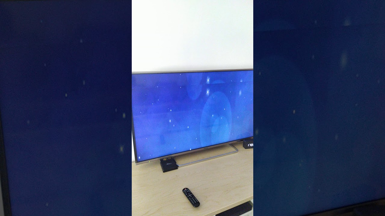

Changing from a 1080i DVB-S channel to 4k and back changes the color map
1080i http://ix.io/2hQt
4k
1080i back http://ix.io/2hQv
Any ideas?
