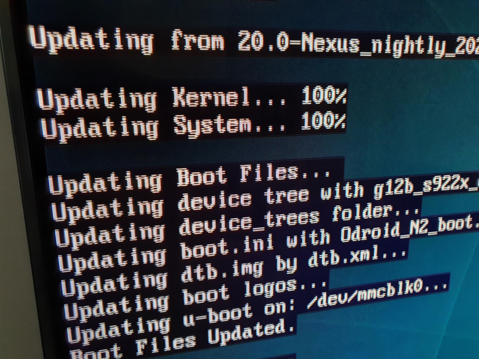

The fuzzy font during the update process. 4K GUI and scaling on.
You have to stop Kodi before making changes to guisetting.xml otherwise they’ll reappear.
from ssh
systemctl stop kodi
then make changes to guisetting.xml and either reboot or restart kodi using:-
systemctl start kodi
Yes, I jumped that part…
OK, after stopping kodi I could modify guisettings.xml easily. The fuzziness is fixed/worked around for the moment and I have a much crisper UI now, too. Thanks! :slight_smile:
Overscan is of course disabled on my TV. The <overscan> sections had seemingly bogus values, however, like {0, 0, 1920, 1080} for 4K resolution entries. That may have caused the quarter-size display(?).
