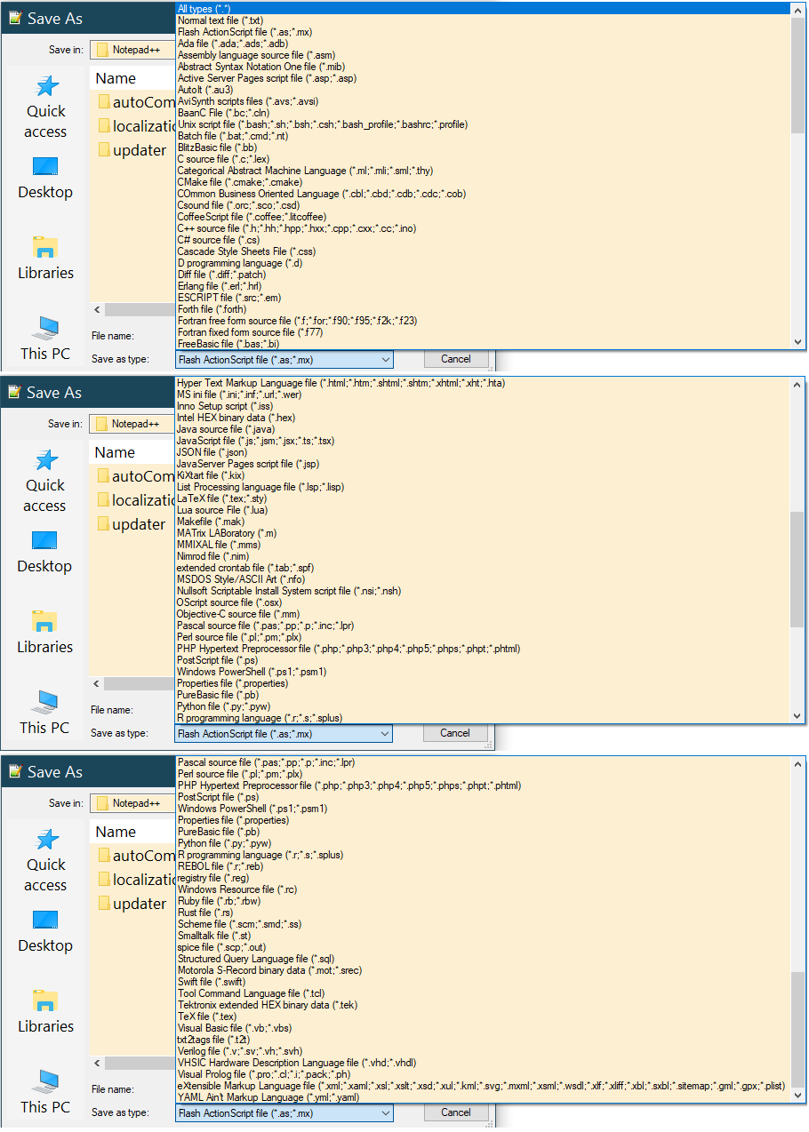

Editors like Notepad++ or Notepadqq are often mixing up “spaces” and “tabs” for example. This and other formatting issues can cause serious Problems.

Never had such problems with any editor. If user press tab then it is tab not space :slight_smile:
For quick editing I’m using Metapad.
interesting fact, microsoft FINALLY fixed notepad, so in future releases you can now choose the line ending type:- https://devblogs.microsoft.com/commandline/extended-eol-in-notepad/

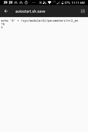

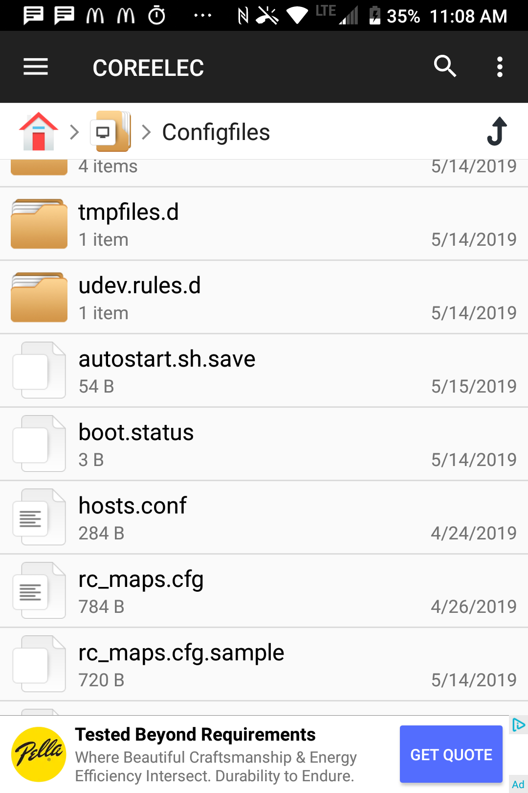

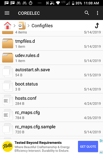

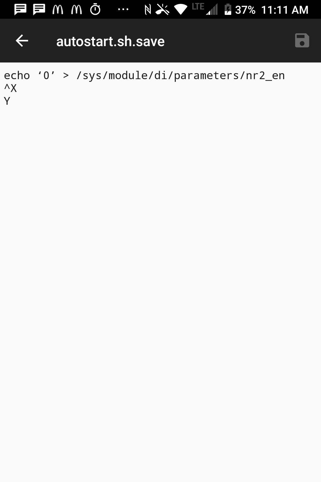

When I ssh into the box to create autostart.sh and then disconnect. When I smb into the box, the file is saved as : autostart.sh.save.
Is this normal? Did I mess a step up?
Ssh and use following commands:
echo "echo 0 > /sys/module/di/parameters/nr2_en" > /storage/.config/autostart.sh
Simple enough! Will try this later! Sounds like that would work.
To confirm (because it was told differently before).
The zero itself . Is it 0 or ‘0’ ?
To append the file (if you already have something in it), you can use >> instead of >.
use the exact command I posted (copy/paste)

Thanks for the trick. It seem to be ok.:grinning:
