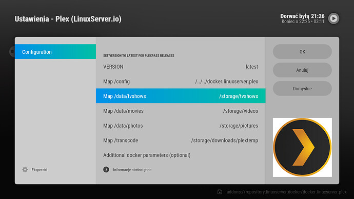

install and done. And you should be able to see Plex website in you browser. And if you can’t see your movie folders when creating libraries, got to Plex server add-on settings and add those folders there and then you will see them in Plex.

When you’re done with your mounts open Plex addon from Settings > Addons > My addons > Services and edit config with location you want to see in plex web interface. It’s really simple.
Just installed to see how it’s build.
You point here to your mounts.
After restarting plex server you’ll be able to add your files to library.

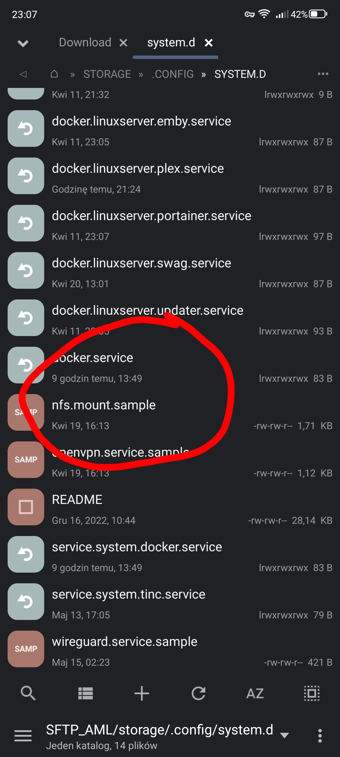

You missing your nas hdd mounts in your CE system.
How can I explain this more clearly? No idea :grin:
Have a look in to .config/system.d folder and you’ll find nfs mount sample file…
