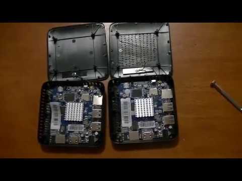

Here is my video from 4 years ago, adding a fan to one of my boxes. I had a couple of the same box without mods, and they worked just fine without the fan mod.

Looking at my video from 4 years ago, that box was running 90c also. But I haven’t modded or added external fans on any of my boxes since then. Have not had one die on me yet.
Yes, that does sound crazy, running these boxes at that temp. Theoretically, they should physically burn themselves up.
But all I can say is that I have a lot of those boxes, and yes ALL of them run hot, but never lost one from heat (that I recall).

I had the components, so I did a proof of concept. I connected an old USB 2 cord to a 5 volt fan that I had on hand. Temporarily, attached the fan to the box, temp dropped from 95 degrees C to 75C. IF, I get the motivation, I will connect the wires to the main board and cut a hole in the top of the box and install the fan. Same thing I did 4 years ago on a couple of Mecool boxes.
The fan is super quiet, no need to install resistors to slow the fan.
