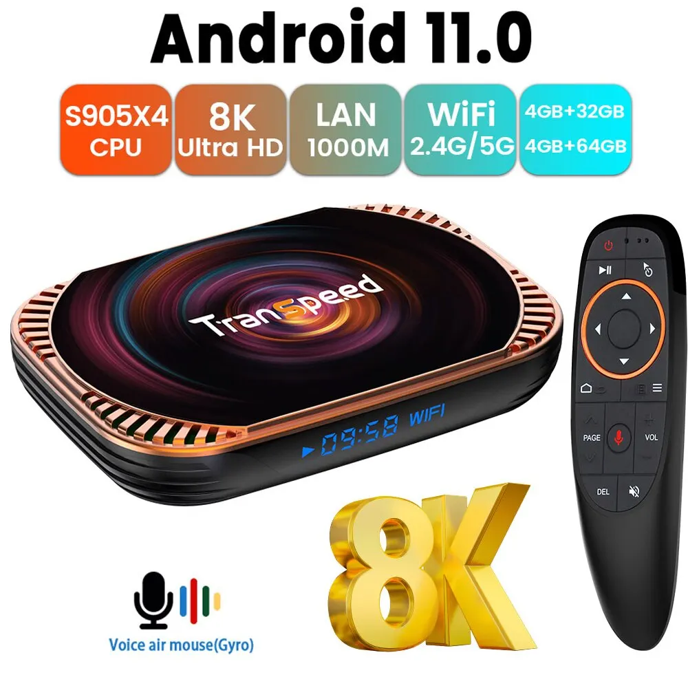

hello
I have had a transspeed s905x4 32G box for 1 week, I installed coreelec on a sandisk sd card (CoreELEC-Amlogic-ne.aarch64-20.5-Nexus-Generic.img), everything works fine except when I activate the mode HDMI passthrough, the image stutters approximately every 2/4 minutes!
do you also have this problem?
how to eliminate this phenomenon?
You are using Passthrough to your amplifier?
AV system?
It should always be enabled
Why enable during playback only?
When you change settings during playback
You will get a stutter
Then will/ should correct itself…
it is permanently activated, I have an audio/video amplifier, I deactivated it to do tests
