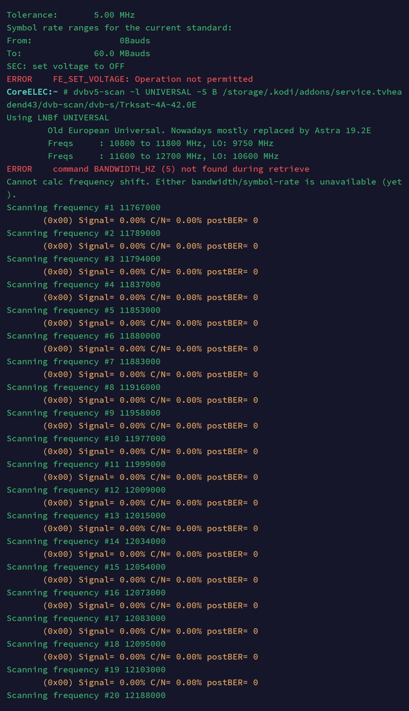

If you look at the txt, some TPs give that error.
Here is Full scan log
scan.txt (24.8 KB)
So there are errors only for some frequencies. but stil for other there is no signal lock. The tuner is not tuning correctly or the demod is not receiving the signal corectly.
I don’t have an idea what can be wrong other that the driver code itself. There is almost no configuration variables other than i2c settings which are correct since there is no i2c errors and oscillator frequency which I can get from Your pictures (27MHz).
So lets try other av201x driver that seems to be more recent, maybe it will work.

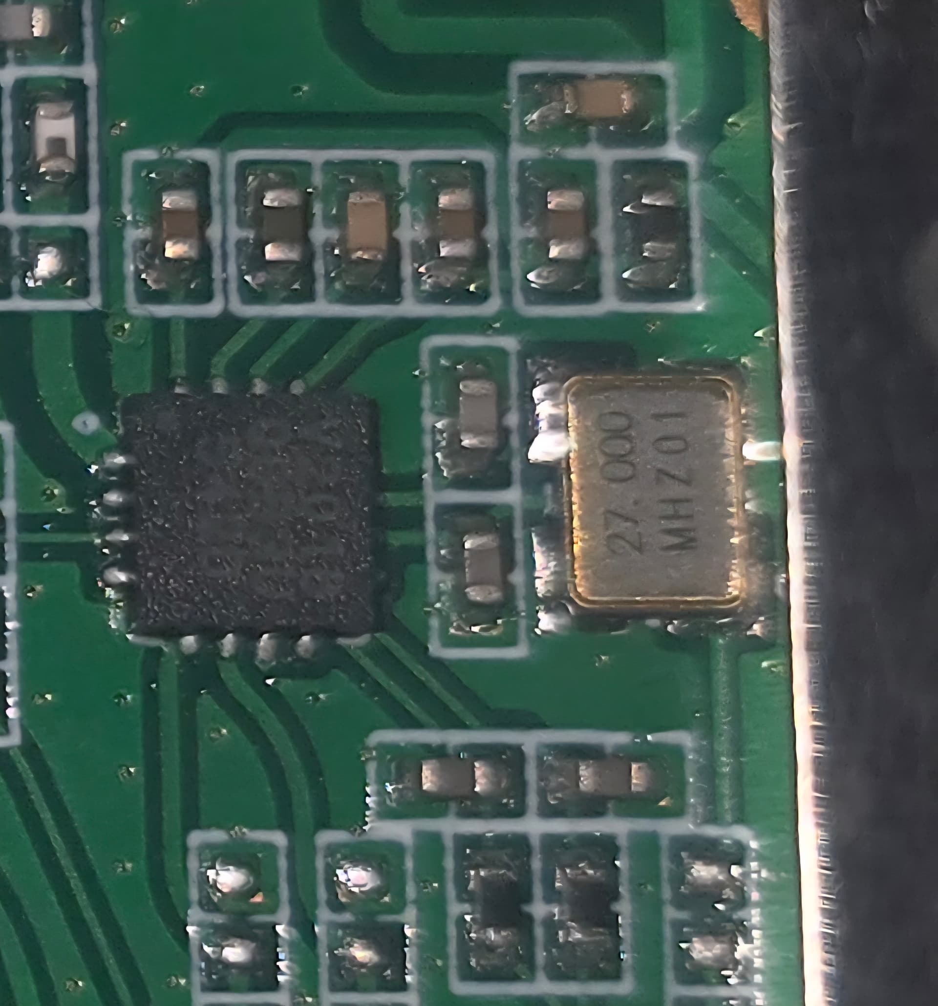

Av2018 27.000 that is true
dvb_meson module from AV6862 addon was not loaded. I tested the last version on my box and for sure it works. I see no module load errors either so it seems like there is no addon installed or something went wrong during installation.
Will try freesh install

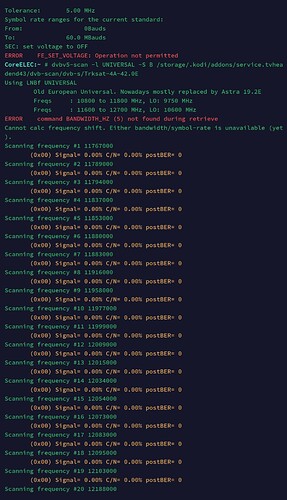

Tuner dont locl
Oh my bad, the DTB has error, faulty tuner configuration. please try this:
sm1_s905x3_magicsee_c500_pro_4g.dtb (77.0 KB)
i2c i2c-2: dvb_meson: Airoha Technology AV201x successfully attached MCZERSKI :laughing:
newaddonlsmod.txt (2.7 KB)
newaddondmesg.txt (76.9 KB)

CoreELEC:~ # dvb-fe-tool
Device Availink AVL6261 (/dev/dvb/adapter0/frontend0) capabilities:
     CAN_2G_MODULATION
     CAN_FEC_1_2
     CAN_FEC_2_3
     CAN_FEC_3_4
     CAN_FEC_4_5
     CAN_FEC_5_6
     CAN_FEC_6_7
     CAN_FEC_7_8
     CAN_FEC_8_9
     CAN_FEC_AUTO
     CAN_GUARD_INTERVAL_AUTO
     CAN_HIERARCHY_AUTO
     CAN_INVERSION_AUTO
     CAN_MULTISTREAM
     CAN_QPSK
     CAN_RECOVER
     CAN_TRANSMISSION_MODE_AUTO
DVB API Version 5.11, Current v5 delivery system: DVBS2
Supported delivery systems:
    [DVBS2]
     DVBS
Frequency range for the current standard:
From:             950 MHz
To:              2.15 GHz
Step:            1.01 MHz
Tolerance:       5.00 MHz
Symbol rate ranges for the current standard:
From:                 0Bauds
To:              60.0 MBauds
SEC: set voltage to OFF
ERROR    FE_SET_VOLTAGE: Operation not permitted
now1.txt (74.0 KB)
Dvbv5-scan txt
scan.txt (7.0 KB)
There’s probably a tuner lock, but the signal isn’t being captured. Some things have changed. The faulty tuner and demo range are displaying external frequencies and symbols. Also, although the tuner gives the voltage correctly as 14/18v on Android, when I measure it on CoreElect, the vertical voltage is correct but the horizontal voltage gives 16 volts. On Android, it gives 18 volts. 16 volts opens it but ..
I have no other idea. tried avl62x1 drivers from those two sources:
with firmware from here:
av201x driver also from two sources, from CE linux repo and from here:
are there any other driver sources ?

silabs tuner av2018 sources
I got the Homatics DVB-T and I can potentially understand why they are reluctant to discusse. It looks like the player they provide uses the licensed dtvkit core and they not even even know how the device itself works.
But the hw dongle itself should not be nothing special?
