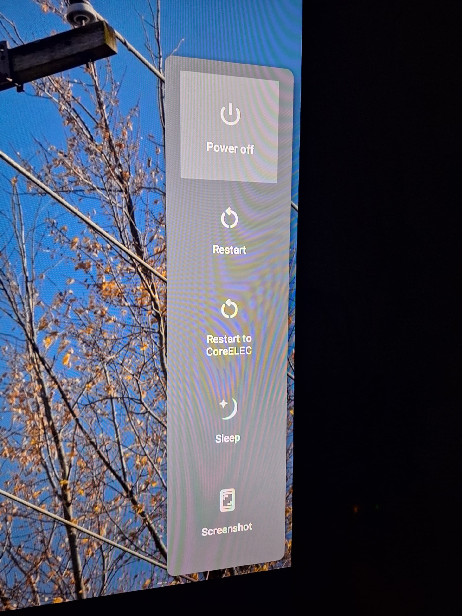

By the sounds of it the factory DCE firmware is going to be as close as possible then. It will boot to android by default, then you can hold the power button on the remote and it brings up this menu…
Also, where you said the functionality was described: Beta Dual Boot Firmware v.0.2.8+ CoreElec for Ugoos AM6/AM6 Pro & X2/X3 Series models, that is the DCE firmware I was talking about albeit an older version than the latest
