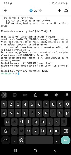

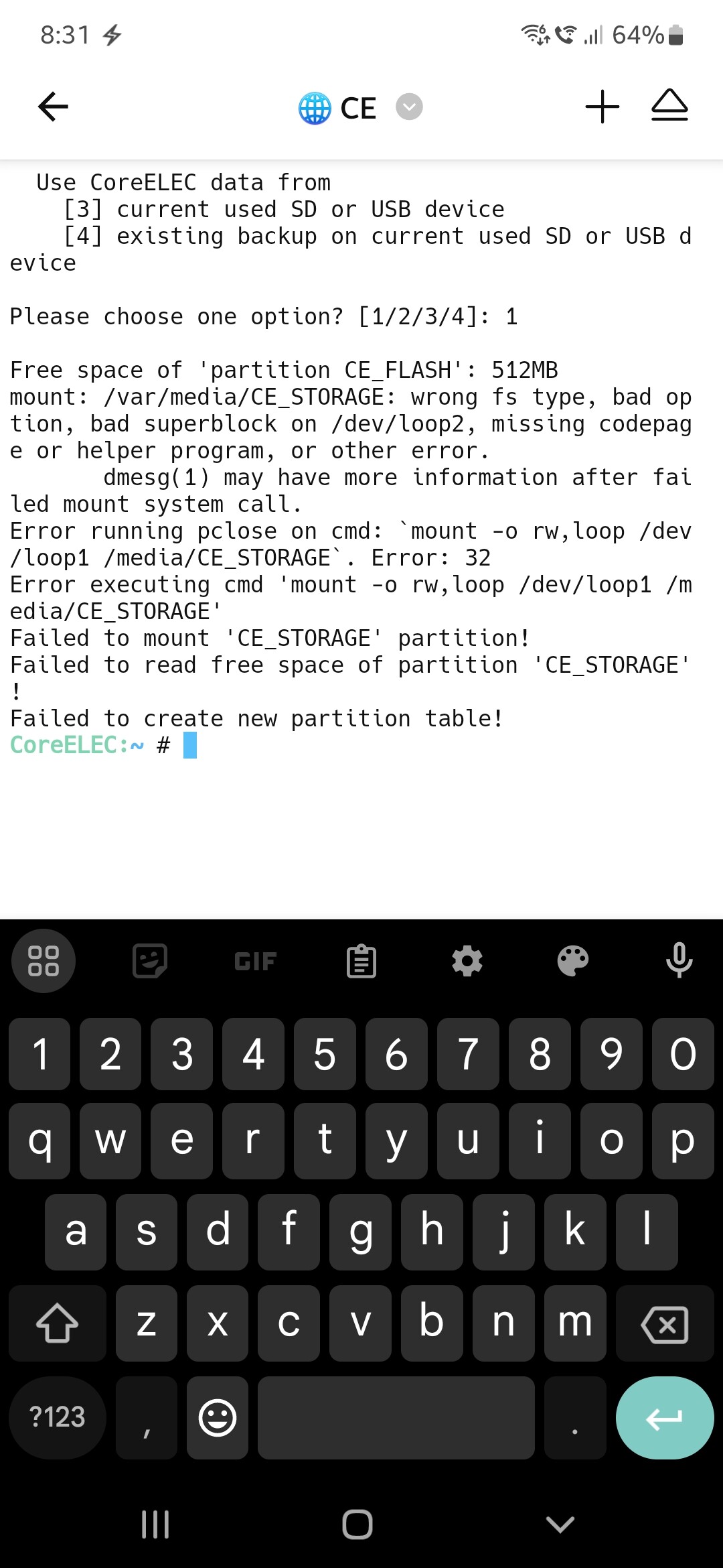

Hi guys, I’m in need of help. I’ve got a freshly reset AM6B and then after booting from a CoreELEC USB I run the cemmc tool and when I try to install it as either dual boot or single boot I received this error…
Please make a dmesg | paste log from you system.

Here you go, thanks:
https://paste.coreelec.org/BlockingLingo

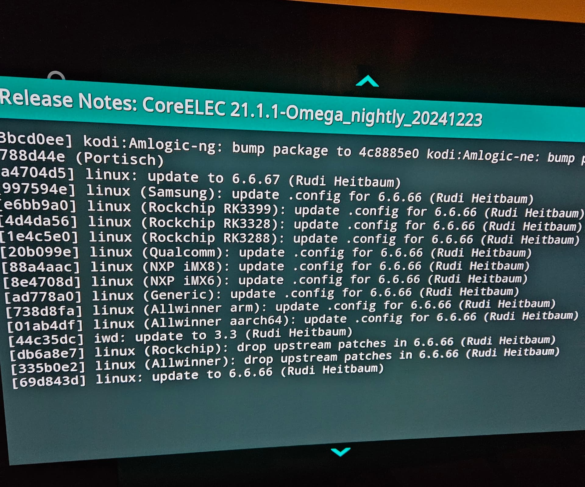

What are these patchnotes meaning? Who is rudi heitbaum? Can we get a simple patchnote overview in the future?
This is changelog from previous build. Because CE follows LE there are changes also for other LE projects and devices.
LE dev.
Why waste precious time to change such minor and not important thing.
it doesn’t seems to minor the me. what is LE dev?
Libreelec, CoreELEC is a fork of Libreelec. Heitbaum is a nice guy, from some place I forgot and drinks beer or not. I don’t know.
Whao, does this mean latest nightly on -ng will use a much newer kernel? Shall we expect any regression on AM6B+?
