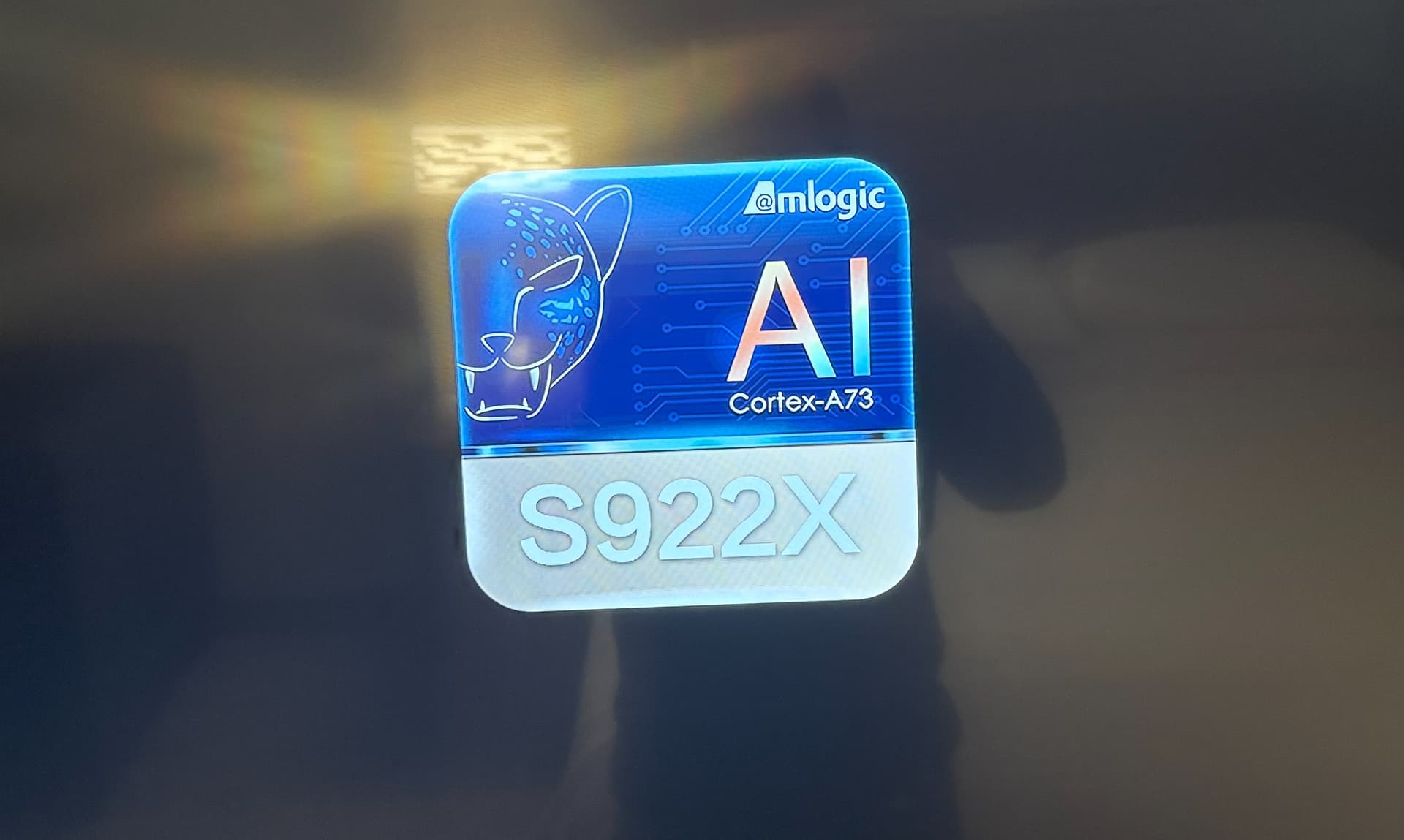

Hello there. First thing, BIG thanks to CoreELEC team for this great OS.
I have got a new UGOOS AM6b+ and trying to install the CE 21.2 (nightly, generic) to its eMMC. Booted it with uSD card, no problem.
SSH, ceemmc -x, #1 option (Dual Boot)
“Not enough space on eMMC for the installation “
“Continue?”
It has 3799Mb free space .
I used this guide for the installation, [Guide] S922X-J (Ugoos AM6b+) CoreELEC installation and FAQs
I’m paralyzed so my access to my computer is limited (will be using my computer tomorrow, I will copy and paste the SSH if needed). I wanted to ask so I can be prepared.
Should I factory reset the AM6b+?
uSD card is 16GB Verbatim (premium class 10) , should I rewrite the image?
Bad box?
Install it with single boot option if you want it on the emmc.
If you need android you’ll have to boot it from sd card or usb.
Really? I thought the single boot is a no no. I have no plans for the Android OS.
Which firmware on your Ugoos?
I have re-release 054n
And have installed CoreELEC on internal with Android 9 in Dualboot
Both OS on internal no issues
Blazing fast
Machine boots CoreELEC first by Default
Reboot from eMMc/nand in CoreELEC takes you to Ugoos 054n Android 9
Long press power button in Android/use restart option
Boots to CoreELEC!!!
***I ignored the not enough space and continued
Partiion was resized
This worked for me
Does not mean is only/correct way to test.
If you do not care about Android then choose single boot
054n FW.
Partition resize, emmc or uSD?
Thanks for sharing your experience. Appreciate it.

I need help in resolving the issue I have. I just purchased AM6b+ box. I prepared boot material using rufus on both microSD and USB drive using file CoreELEC-Amlogic-ng.arm-21.2-Omega-Generic.img.gz and renamed “g12b_s922x_ugoos_am6b” from device tree to dtb.img and put on the root folder as well as dovi.ko. And I used ‘toothpick’ method for rebooting. However, the boot stuck at Amlogic logo as shown in the picture. The logo is displayed for about 10 seconds ad then disappear for about 5 seconds and this cycle is repeated forever until I turn off the power. The firmware of the box is 0.5.4n.
I searched this discussion and couldn’t find any post for the same issue. What I could have done wrong? Any suggestion is appreciated. Thanks.
What size SD and USB are you using?
Wrong SD Card or USB Stick?
And dont leave the Button!!!
Press and keep pressing the Recovery button on the bottom of the device, then Power ON the device while keep pressing the Recovery button until the CoreELEC screen appears.
First Release the Recovery Button, when you see the CoreELEC screen.
Dont forget the UR01 remote.conf in the root.
32GB for both microSD and USB which is a USB 3.0 drive.
